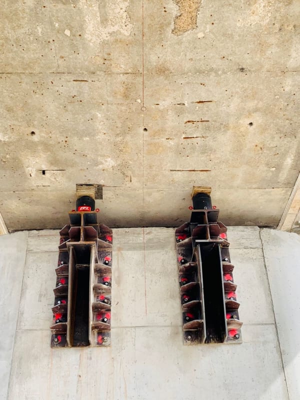

Friend came to me asking for a structural solution for construction mistake, that some column were rotated (90 degrees)
my suggestion was to similar to below drawings. Also we i searched for others solutions found similar techniques
My question is there any other better solution
Would like to hear your opinions (Positive & Negative one) and thanks in advance ..
Note: only four (4Ø16mm form 12Ø16) longitudinal rebars were continuous for bottom level column to the top level column

do have information about the shear-studs (threaded bars) capacity
i think whole idea is controlled by Fv of these bars (the blue dashed lines)
also i found similar idea, were they use it to lift bridge girder (below picture)
Also one more question, could we use post-tensioning method to increase the lateral confinement of RC columns ?

Regarding capacity of the anchors, I actually believe that installing thru-bolts in an existing column is a fools errand. There's usually so much reinforcing at the top of the column that getting them through without damaging reinforcing is near impossible.
I would likely be designing it based on epoxy or mechanical post-installed anchorage requirements.
thanks jayrod12
"Installing thru-bolts in an existing column is a fools errand", might be justified for cost effective ?
Don't you think its more effective (stronger) than epoxy or mechanical anchorage ?
Probably, but there's no published literature for thru-bolts as far as I'm aware. This conversation has been had a few times, more geared towards masonry but sometimes in concrete, due to the bending of the rod in the hole you end up with some fairly substantial bearing stresses right at the start of the hole.
I'm probably not the guy to wax intellectual on it though. I just know how I'd design it if I were doing it.
I think will do it using ABAQUS and see how it goes (up to failure)
Also assuming some tolerance (0.5 mm) between the rod and the drilled hole
just to understand the mechanism.
