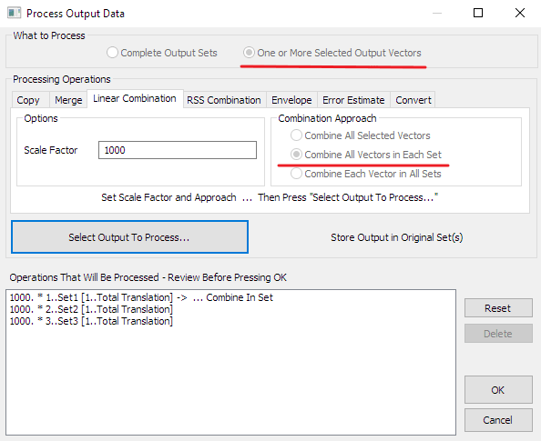

Hi guys, I need some help (yet again).
i have an output set which contains the results of a forced frequency response calculation, spanning from 5 to 60 Hz, in 0,5 Hz steps. The calculation is performed in SI units, which results in vibration velocities in m/s. As the calculated values are low (max. 2 mm/s) I want to convert the results from m/s to mm/s (x1000) before I draw a graph with the charting option.
I tried model/output/process, but this doesn't give a good results (it creates a single output vector??)
Anyone any idea how to go about this?
Thanks in advance.

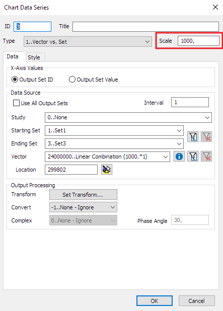

You are using right tool. Set up Model->Output->Process like shown in the picture and select only one output vector at a time. Thus all new vectors will be created in each sets at the bottom of list. Repeat this with all vectors you want.
Than you can use Model->Output->Vector to edit auto-generated vector name.
On the other hand you can set scale factor in charting.
