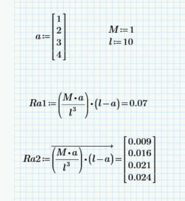

I was hoping someone may be able to help me with an issue I am encountering using MathCAD Prime 9 relating to the use of arrays to solve an equation which contains a variable which has multiple values.
To provide context, I am looking at analysing a simple beam with fixed ends with a moment which is applied moment at discrete positions alone the beam length. The objective is to determine see how the magnitude of the boundary reaction forces change at each moment position, which is defined by the variable (a), using the following equation taken from Roark's Formulas for Stress and Strain:
As (a) has multiple values I have defined these using an array i.e.
For some reason rather than providing a number of answers for (Ra) in the form of an array for each defined value of (a) the equation returns single scalar number which appears to occur on account of the equation involving the multiplication of the array variable (a). Can anyone advise as to how I can instruct the software to provide an answer in the form of an array for rather than a scalar quantity?
Any advice greatly received!
First, this being a Mathcad question, it should have been posted in forum552.
When you multiply two matrices like you're doing, Mathcad assumes you want the dot product of said matrices, which is a scalar. If you want to evaluate the equation element wise, then you need to vectorize the equation. Highlight the entire right side of your Ra equation and then either:

Here's an example of what I described above, done in Mathcad Prime (what OP is using):
Ra1 shows what I believe is the problem that OP is having, while Ra2 shows the vectorized version that evaluates the equation element-wise (which I believe is what OP wants to do). I'm sure there's plenty of other ways to do it, but this is very simple and fast.

Thanks for the responses all, in this case the recommendation provided by Stick seemed to do the trick nicely (i.e. to 'vectorise' the equation) and negated a lot of unnecessary duplication which was great. Next time I'll be sure to post to the correct forum though as i didn't realise there was one dedicated to software queries, very useful resource. Thanks again...
