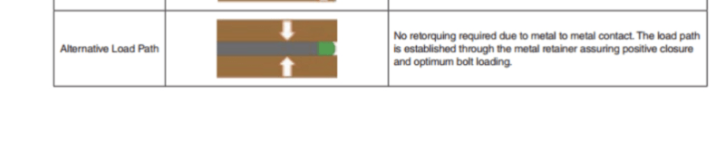

I have a packed rectification column 2.2x25m, operating at vacuum 30kPaa@200°C, installed outdoor, no roof, no windshield, continious operation >8k h/y. An engineering contractor has proposed no access holes and shell devided by flanges, spiral-wound gaskets for piping&instrumentation flanges, asbestos gasket for shell flanges.
I appeal to mech engineers involved in rectification design befor. Please comment is it possible to find a gasket material suitable for such service? My concerns are mostly related to bottom flange:
wind load + column weight + packing weight + liquid weight = uncontrollable air leak
PS
Please do not recommend change the design. I know, I know...
You can also fabricate your own concentric rings and use an off the shelf o-ring. You may need to do this to support pressure in both positive and vacuum conditions.
Construct the metal washers so that their thickness and diameter difference matches recommend o-ring groove dimensions.
