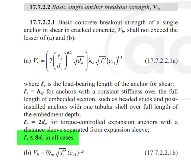

Bag, you can check the bearing strength of the strut which will bear on the vertical pier rebar and the anchors.
The load bearing length on the anchor is defined in ACI (I think usually max of 8*d and embedment length).
If your anchor length is inadequate for bearing, you may need to increase embedment or anchor diameter.

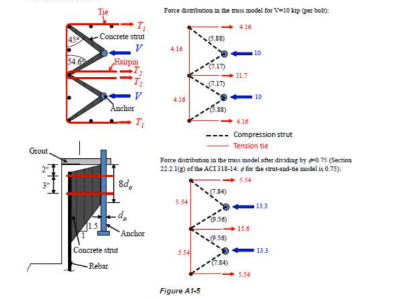

This photo is taken from PIP STE05121, which gives examples on properly designed anchor reinforcement.
Per PIP we typically do 12 x Da and call it a day if there’s minimum tension.

Correction to my last reply - the load bearing length is the minimum of 8*d and embedment length.
How are the shear forces transferred from anchor rod to concrete assuming shear reinforcement is provided?
Is it through bearing of anchor on concrete? Where can I find equation for anchor rod bearing on concrete?
Depends on your setup.
You can have the anchors bear directly on the hairpin or you can use a strut an tie model.
I highly suggest reading PIP STE05121.

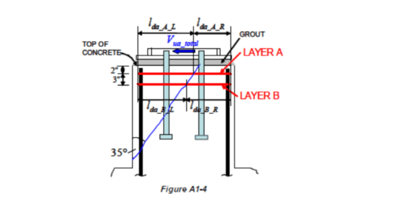

If I have a setup similar to ACI R17.5.2.1b(ii) then what happens? Is there a bearing equation for this set up as well? Cannot find anything in ACI for bearing.
Bag, looking at ACI R17.5.2.1b(ii), you can probably ignore bearing if you are able to develop the bar on both sides of the breakout cone. Also, the recommendation for using anchor reinforcement #6 or less is only applicable to R17.5.2.1b(i) (ie. the hairpin setup). There is no issue using #8 if you can develop the bars.
The strut and tie model is only needed if you cannot develop the reinforcing on both sides of the breakout cone.
The PIP document goes over both methods (ie. the strut and tie method or the simplified method, where you develop anchor reinforcing both sides of breakout cone).
Simplified method:

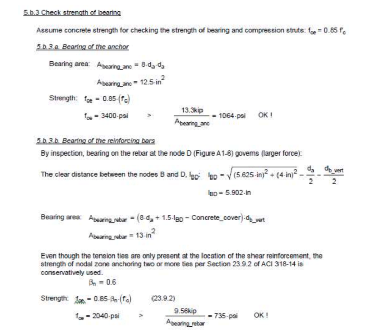

This is where I am getting stuck. If I ignore the bearing check, how is the shear transferred from anchor to concrete?
Also do you have the PIP document you can post?
Good question, PIP and ACI do not go into detail about this.
Not exactly sure why there isn't a bearing type check in ACI for shear breakout.
I suppose you could still check bearing over the load bearing length of the anchor (using method I posted above)
This would be sort of similar to how the nut of anchors in tension bear on concrete, which fans out into a breakout cone (ie. pullout failure).
So, if your anchors don't crush concrete locally over its load bearing length (ie. bearing check) and if you anchor reinforcing secures the breakout cone to the rest of the pier you are good (ie. develop both sides of assumed crack).
I would also probably add a couple more anchor reinforcing bars in, especially if you don't take into account the eccentricity between the baseplate and shear reinforcing.
So the bearing are for anchor is pretty much 8 x dia x dia. I wish this was explicitly mentioned in ACI
