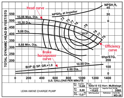

I have some equally spaced point of a fire pump curve (flow rate-pressure). The data-sheet doesn't show the rated capacity. Is there a way to analytically find it? How the producer of fire pump determine it, once the experimentally obtain the pump curve?
If this is a centrifugal pump then the "rated" flow is quite a large range. Typically the preferred flow is within 10% of BEP, but fire pumps work to a different way of thinking.
They need to be able to flow 150% of rated flow I think without disintegrating.
Thanks. How can I find the BEP?
Its plotted on the pump curve.
Usually found by testing I think.
BEP =Best Efficiency Point
Example and guidance below.

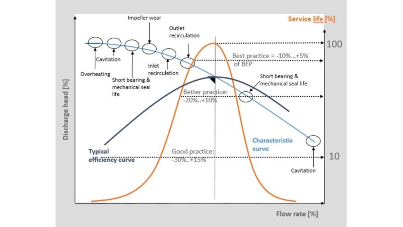

https___live-resources-e2e-sales.ksb.com_resource_image_230298_landscape_ratio16x9_3300_1856_9e275321b9cd6b597611fdac77c36654_7F1341E3993327B7F468447E9C614914_pic-service-life_lqw5nx.jpg
Often shown as contours like this.
Ok... I can't find it in the catalogue. I think I should ask to the producer tomorrow. It could have been nice to calculate it by myself. Thanks!
Beware that fire pumps work to a a different way of thinking altogether.
Efficiency is irrelevant, it just needs to be able to pump what it needs to and then do 150% of flow without falling to bits.
Oh and survive regular dead head / no flow ( the latest NFPA codes are a bit better) for 30 minutes at time every week and survive.
Efficiency is quite possibly not measured....
