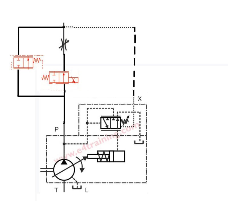

Hello there!
I am designing a boom for load pickup, which also has to rotate. And one of the requirements is to reduce the speed of extension and rotation of the boom at the end of the ligting. What I mean by this. For the first 30 seconds, the boom has to lift at a speed of 0.3 m/s, and for the last 10 seconds, the lift speed has to be 0.03 m/s. I'm not very familiar with hydraulics, I'm just starting to learn it. So far I have realized that I need to use a hydraulic proportional valve and adjustable axial piston pump. I understand a little bit about l-s control when the pump changes pressure if the load on the boom changes. But I can't figure out how to forcibly change the boom extension speed when the boom load is unchanged. Could you please advise me in which direction to look and what equipment to pay attention to? And also how it can be organized.
Thank you!
A proportional valve is only needed if you need proportional control. If you are okay with "bang-bang" and don't need precision motion control (precision following of a motion profile, precision speed control, precision positioning) then there's lots of ways to do this:
- Dual fixed-displacement pumps. Cut the big-displacement one out of the circuit (short-circuit its output to tank and block its output connection to the pressure side of the circuit) when you need to go slow.
- Or, include a flow-control in the circuit, but use a two-position valve to bypass it when you need to move fast.

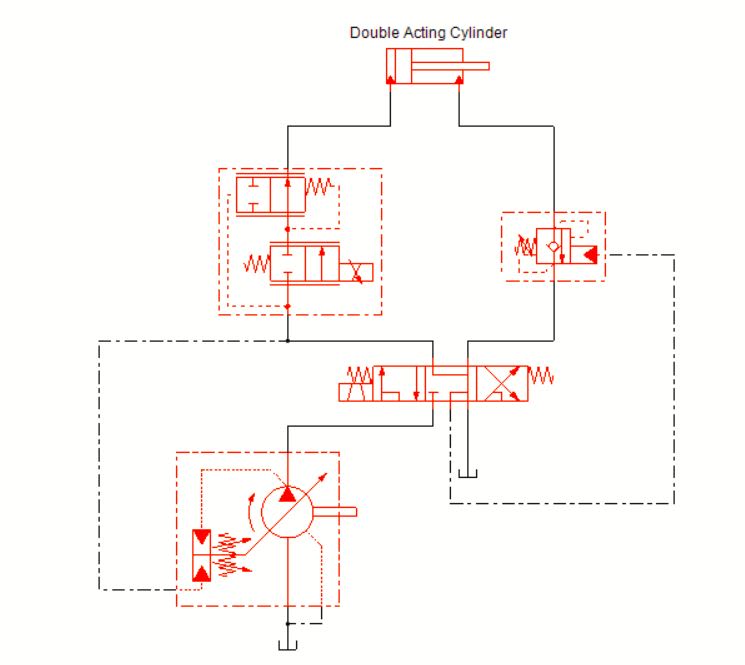

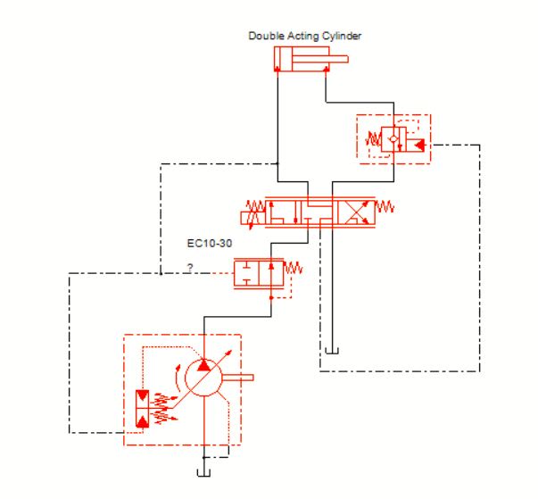

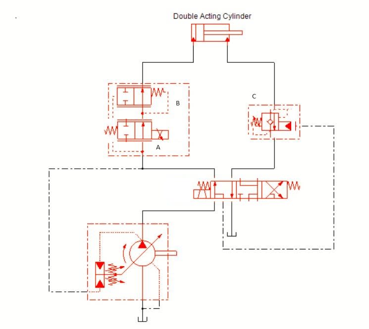

Thank you, FluidPowerUserm, for your answer! Sorry for enjoying, but a little bit confused with your example hydraulics scheme. We move proportional valves "A" and "C" to the left and this will be the full flow, but what position must be to reduce the flow?
That scheme is just one example of how the system might look.
Valve "A" has two parallel lines on the symbol. That means the position of the spool can be infinitely controlled. Therefore, as you adjust the current to the valve, it will open. In your case, you might give the valve 75% of max current to move at 0.3m/s and then back the current off to 30% to get 0.03 m/s. It's a proportional flow controller with built in compensator.
The control system would detect the cylinder position with a switch or linear position sensor (LVDT) and drop the current.
It won't work as drawn, there is no oil flow path in the other direction, it would need a check for reverse flow. It is just a rough example.
You can see that the pump is measuring the pressure differential across the directional control valve. The pump could also be changed to displacement control and the control signal would change the swash angle of the pump to change the flow. It's more efficient that way, but also much more expensive.
Ok, it seems I got through your variant and the idea. Yesterday I found some schemes with the flow control. Yesterday I found some schemes with the flow control. There are now two (possibly three) possible solutions in my head:
1. Use a hydraulic throttle (or proportional valves) with a pump that changes the flow depending on the pressure difference behind and in front of the throttle (valves). The approximate hydraulic scheme is below. But here I have a question if I can add L-S regulation here?

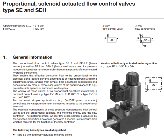

2. The second variant is to use proportional, solenoid-actuated flow control valves. Some engineers gave me this advice, but I need to read more information about it.
3. And the third variant is to use displacement-controlled pumps. Something like this
If you have any comments, please, let me know if I am on the right way!

Option 2 is pure flow control
