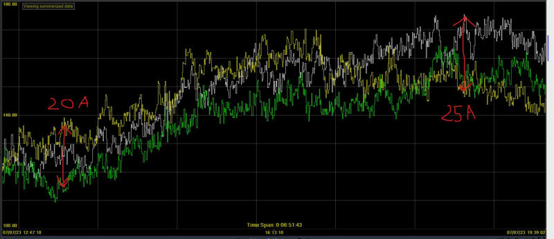

jghrist-Does your criteria have any sort of minimum load? I have lots of locations with large imbalances on relatively small loads (e.g. a 600 amp rated circuit with 40/50/60 amps is a 20% imbalance). In many of those locations I see the balance shift by 10 amps or more throughout the day. I think my own practices roughly align with a limit of 15% of the circuit rated ampacity rather than 15% of measured amps.
This is an example of a circuit where the imbalances changes quite a bit through the day. At lunchtime the yellow phase is the highest by about 20 A, whereas at dinner time the yellow is the lowest phase by about 25 amps.
Our criterion is for peak feeder loading and does not address the magnitude of the peak. We have found lightly loaded feeders that exceed 15% imbalance but had no voltage or capacity problems. We made exceptions to the 15% requirement and did not recommend rebalancing the loads. The 15% is not a code requirement, so engineering judgement can be used.
