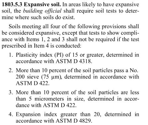

We do have a soil consultant who has prepared the attached bore log (soil report) based on testing. But this report doesn't say anything about expansiveness of soil, I am concerned since it is clay. Before going to the soil engineer I wanted to do my homework. From UBC-97 I found the criteria that expansion index should be greater than 20 for a soil to be expansive. but this report doesn't give any such value. I was worried if I could figure it out using some other values.

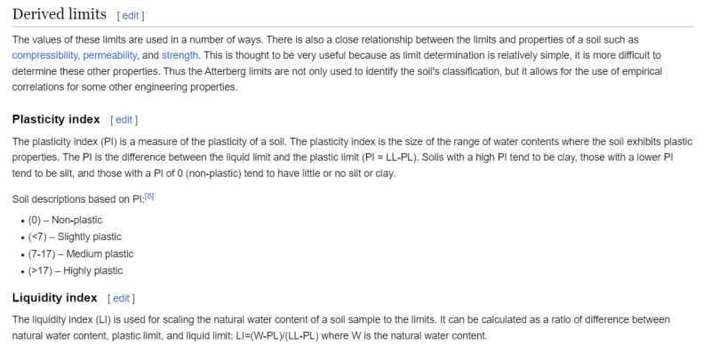

Did they determine the liquid limit or plasticity index?
Yes, have a look at the attached bore log. It is the same soil I am concerned about.
The plasticity index (PI) is the difference between the liquid limit and the plastic limit (PI = LL-PL).
Soils with a high PI tend to be clay, those with a lower PI tend to be silt, and those with a PI of 0 (non-plastic) tend to have little or no silt or clay.

The boring log shows one sample with a PI of about 10, which is not considered very high; not a red flag for being expansive.
And per IBC definition, it's not expansive since PI<15.
