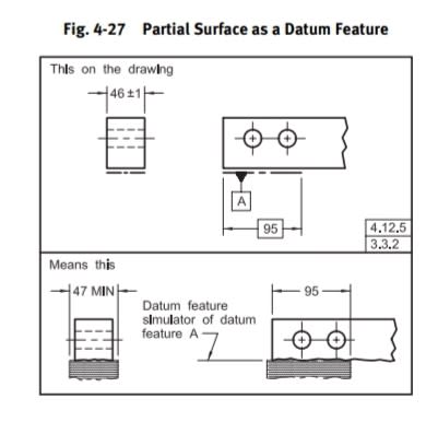

It's from ASME but may be also applicable in ISO.
Luckily you have a cylinder so the datum will be understood as the axis even when the datum feature indicator not attached to the diameter dimension (but to the chain line).
Thanks for finding this, maybe it applies to ISO. It is fairly clear, but I still think my notation is clearer, even if it's not technically correct. And at the end of the day we're trying to convey information, so I'm tempted to go off book in this case.

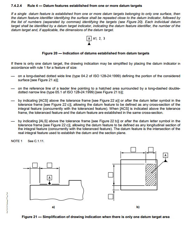

Under ISO you need to specify a straightness or specify the envelope principle to not accept a noodle.
The method Burunduk mentions is not directly applicable in ISO. ISO 5459 requires the datum symbol to be attached to the dimension line of a feature of size under Rule 1 of the standard. To restrict the datum to the first 150mm you could use the dashed line with a datum target. The dashed line should be dimensioned with a TED. I think this is the clearest way to achieve what you're after.
Ryan.
Ryan proposed the best method - defining a datum target area.
Equally applicable in ASME and ISO too.

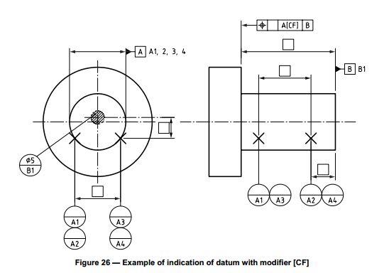

A1,2,3 exactly as shown in the ISO figure is now also required in ASME when the datum feature symbol is used in conjunction with datum targets for the same datum feature. See the end of sub-para. 6.3.3.1 in ASME Y14.5-2018 and figure 7-64.

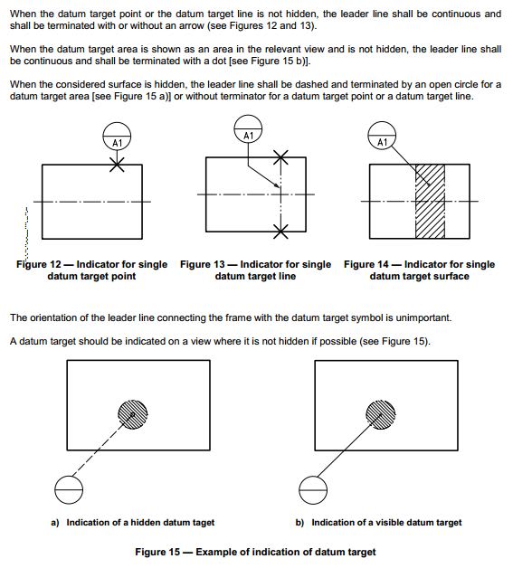

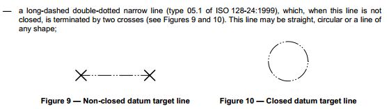

For the second question, yes, there is a bunch of other differences between the two systems. I will just paste a few figures from ISO 5459:2011 to show some examples (hopefully it is enough to see the difference):
Figure 9:
Figures 15a & 15b and the associated text:
Additionally, in the cases where the type of the associated feature establishing the datum is different than the type of the datum feature itself, datum targets are used and the [CF] indication (Contacting Feature) follows the applicable datum letter in the tolerance frame (as shown in the example below). As you well know, this modifier does not exist in ASME.
Gotta love the redundancy. And the inconsistency. A1, but not A2, A3, A4. Is that because they are concerned about saving the extra millionth of a second it takes for the computer to draw that?
How is the diameter a datum feature when the datum targets don't form a diameter?
You would have to ask them. I guess you would have to ask ASME as well, since they are now parrotting this practice.
Maybe because by definition datum target is a "portion of a datum feature which can nominally be a point, a line segment or an area". Again, it is much safer to ask them directly to know for sure.
