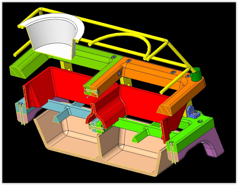

Just a follow up on why I was asking all the questions above. Thanks again for all the help.
As I said above I'm playing around with 3D printing. Want to design a stand to get my pet bowl off the floor. Over the top, but it was fun to design. You have no idea what you are going to end up when you start. The yellow part and bowl is what I had to work around.
