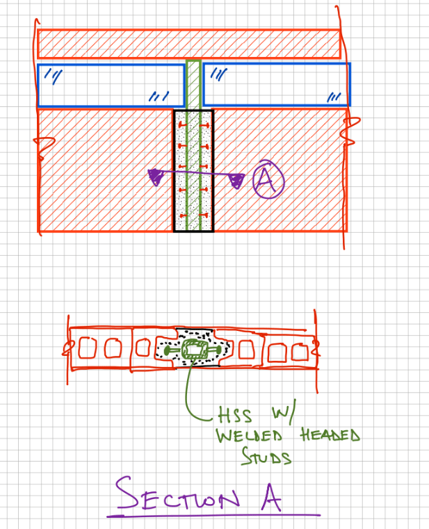

I've got a request for clerestory windows on multiple sides of the structure. This would invalidate the 3-sided diaphragm... so am I back to cantilever columns? My shell is masonry and I can sneak some vertical steel columns into the wall to recreate Photo 1 for hurricane territory.
That sounds alright to me other than the fact that you'll have high demand anchorages at the post bases with both shear and moment. I don't have great confidence in exotic anchorage to masonry. Any chance you could get a CIP capping beam for the top couple of courses just to facilitate a clean anchorage condition?

This is my approach. I've been able to get the shell contractor to do this without complaints in the past.

Your "Section A" detail above looks reasonable to me. I've used a similar detail before with an I-section (except in a wood wall not masonry).
One other thing: In designing the overall wall, be sure not to neglect out-of-plane wind forces. I find that this aspect of the design is often overlooked.

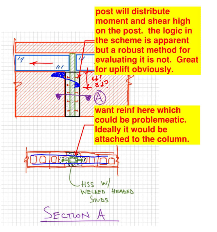

Yes, good point. What I've done in the past is provide a concrete sill beam at the bottom of the clerestory window. Wall is designed to span vertical. Sill beam spans horizontal and reinforcing engages at the steel column/studs with hooked bars at the solid concrete band, or a I'll place welded couplers on the tube to receive rebar. As Koot mentioned, not really a straight forward way to analysis this but I've made sure to apply some logic per ACI 318.

want reinforcing here which could be problematic
Regarding the horizontal joint reinforcing... I'd typically interrupt the reinforcing at the location of the tube. Each of the CMU segments on each side would be treated as individual shear wall elements. They get their own end zones for vertical steel reinforcing (shear wall chords). Lateral load is distributed to the shear walls via the horizontal sill beam (similar to a reinforced concrete tie beam) that I mentioned in response to Eng16080.
I showed welded headed studs along the entire vertical length... after reviewing my details, I usually have studs in that end zone that you showed at the top of the wall, not the full height of the embedded column. Is it the most sophisticated method? Probably not
KootK said:
Great for uplift
That's a huge part of this solution.
