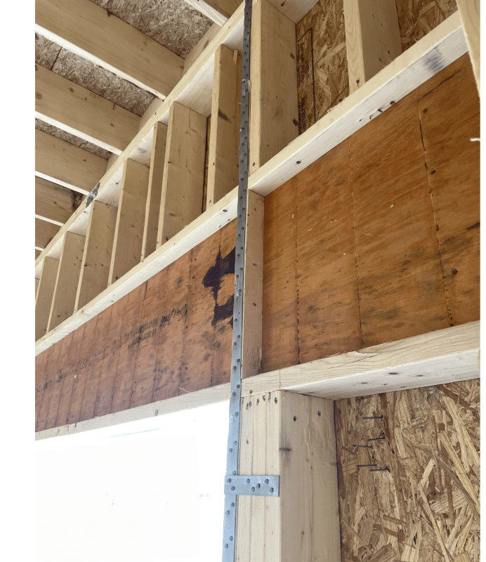

Here's a nice one from a tract house I was looking at yesterday. I am sure that portal frame will function as intended!
