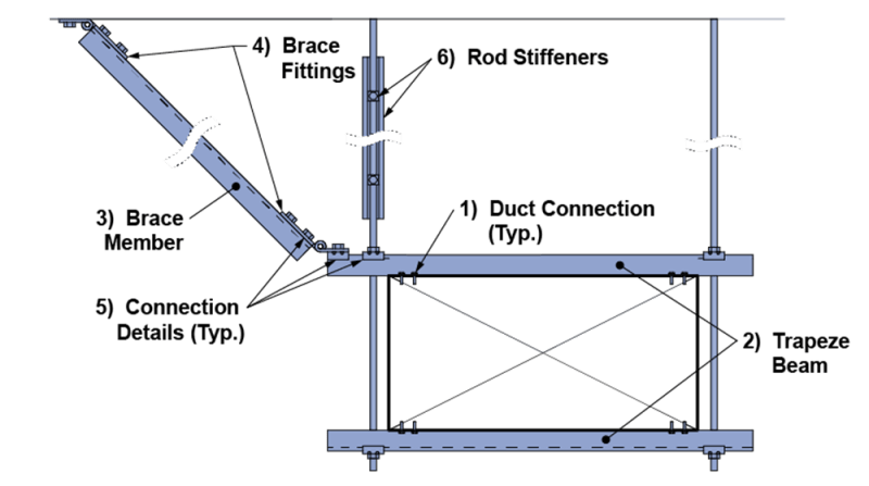

What a mess the threaded rods are going at an angle through the beam? How far away is the next wide flange? I'd probably make them re-hang this, something similar to the duct trapeze, image below, with a small channel or even a double strut for vertical support to the next beam.
Cable sway bracing would be okay or unistrut, though attaching to zee purlins is not something I would normally recommend. How much is the lateral load (Fp)?
They have some angled brackets at the unit and the steel beam, so the rods themselves don't go through at an angle.
