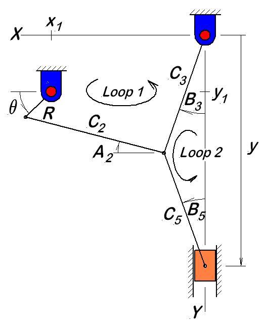

Hi all,
I've really been struggling to come to determine a formula which calculates the mechanical advantage of a system.
The system is a vertical pneumatic piston which actuates a connecting rod, pushing a bell crank to push against a wall.
I need to determine the mechanical advantage (wall force / piston force) based on the changing geometry. I've derived an equation which states that the mechanical advantage is proportional to tan(q). The piston can actuate up to a connecting rod angle of 88 Deg based on the distance of the crank to the wall. I don't know where his is going wrong. I've attached my derrivation.
Hi Greg, thanks for your input. Why do you think this? Is there a relationship between the Fp and the FS term that I have missed?
My derivation suggests that the wall force would tend to infinity which obviously cannot be true?
O
Simple logic, if you push on the end of a link at 90 degrees tot he link you can't generate an axial force.
Cheers
Greg Locock
You're missing a moment reaction at the cylinder bushing, and a horizontal reaction of the piston against the cylinder wall.
Anyways, mostly what this machine will do is destroy pneumatic cylinders.
The assembly is mounted inside a unit. The point of the assembly is to push the unit laterally away from the wall. This is the entire assembly and has been shown to work in practice. Annoyingly I need to define the ratio in a formula to allow us to assess the rest of the part. There is a fixed pivot is ridgedly attached to the piston.
Thanks Greg, I agree that the at theta = 0 it will be P*A*Lx/Ly does this not align to my diagram? At theta 0 FS=0. I'm not sure what mistake you are referring to?
That's a good point MintJulep, I hadn't considered the moment provided by the guided support. I believe that the addition would make this case statically indeterminate? Or do I misunderstand
The questions boil down to can I get an equation for the mechanical advantage for all angles, if not what is the maximum mechanical advantage of the system.
???? said:
There is a fixed pivot is rigidly attached to the piston.
Depending on how I imagine that statement, it might (mostly) allow the cylinder to act only axially.
Sorry if I'm not clear. The bellcrank pivot is ridgedly attached to the piston cylinder by a plate.
