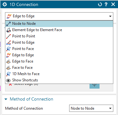

I am trying to simulate contact using SOL 106 using GAP elements in SimCenter 3D. I want my GAP elements to connect 'matched' nodes which I have created on my mesh by projecting a point set along a vector onto each of the 2 meshes which I want to be in contact. I am using the 1D connection function and I wish to be able to select all the points from the first set and all the points from the second set and have the GAP elements connect along the same vector. Unfortunately, whichever 'Method of connection' I try, some of the GAP elements cross over each other, instead of connecting straight down (in the image orientation) to the corresponding node below.
I don't want to manually connect each node from one to the other and I was hoping there was a way to enforce the 1D elements to be connected to the nearest node along the vector.

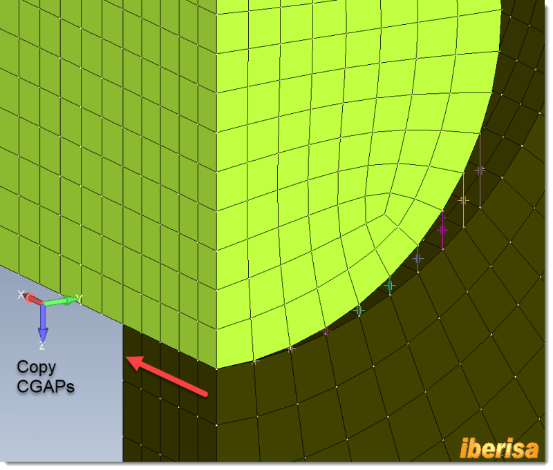

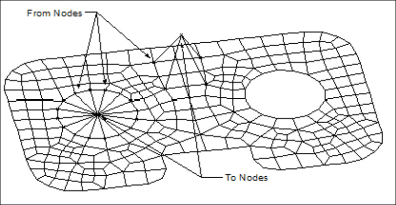

Reverse the order, we have the same command in FEMAP "Mesh > Connect> Closest Link" and the key is to include in the set "FROM" all the nodes that will have a GAP element for sure and in the other set "TO" the rest of nodes, the command will choose the "nearest" node. This is a useful method to automatically generate a series of connections between two patterns of nodes or between a pattern of nodes and a single node.
In my blog of FEMAP here you have a CGAP example of contact Hertz:

Blas,
Unfortunately (as far as I know), SimCenter 3D doesn't have an option similar to FEMAP 'closest link'. See image from the 1D connections menu.

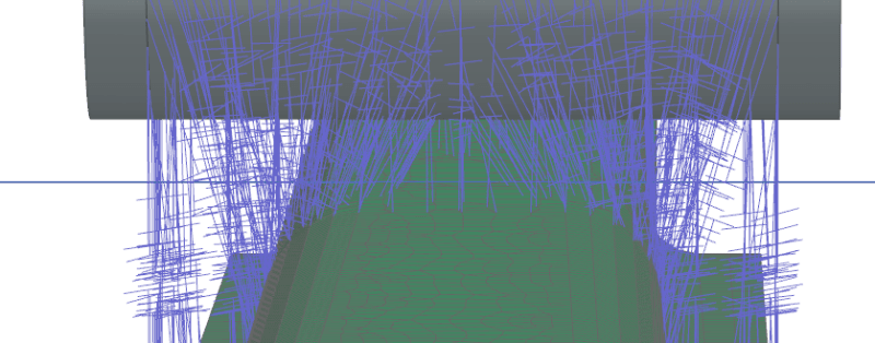

If I am understanding your question correctly, the nodes are all different distances apart. My expectation is that some gap elements will close before others. Here is a view from the side with the forest of gap elements that I am trying to figure out:
