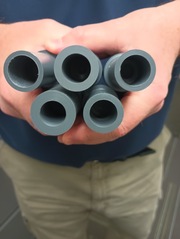

I teach a course in Manufacturing Processes to Engineering students.
My philosophy is "We are not in the business of training Technicians, but educating future Engineers." If a student wishes to become a Journeyman Machinist, I suggest they go to a different school.
They get three lectures to learn the terminology & math of turning processes.
One lab is used to explore how to run a lathe and make a very forgiving plastic part. I don't grade on dimensional accuracy on what is most likely these student's very first time to touch a lathe. That would be stupid: it takes many hours of practice to become proficient at precision lathe operations.
Here's the end result of a very fun & entertaining lab experience: every one of those bores is supposed to be 0.7 inches in diameter.
It makes for a fun afternoon [smile] and the students learn a lot.
My lesson for the day to these future Engineers:
"If you have the time, equipment, inclination, and talent to be your own machinist, then go for it. Otherwise focus your efforts on being an Engineer and pay a qualified machinist to do it for you."
