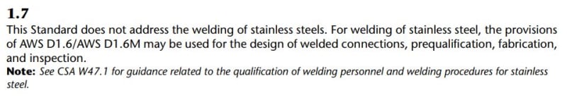

Yes, this is the case unless mandated by the client otherwise (with caveat below). Really no different, in principle, than any metal construction made in China and sold in home depot. It gets somewhat harry when local building codes specifically reference particular CSA standards though; in those circumstances compliance with the CSA standard becomes a legal requirement.
Though not sure why you reference W59 in a stainless steel forum since W59 excludes stainless and CWB weld inspectors are actually trained to AWS D1.6 (most people that lurk this forum are here for stainless). Assuming you're not talking about stainless you'd get more traction in the structural engineering forum IMHO.
