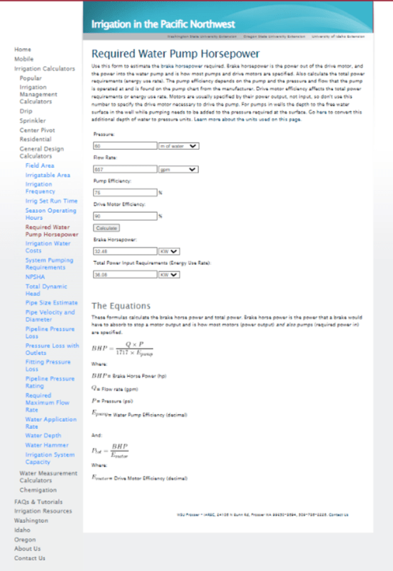

i'm working on a project to upgrade a pumping station. pump is 1 duty / 1 standby.
Qavg = 886.26 m3/d
Qpeak = 3582.4 m3/d
Forcemain pipe size = 150mm
static head = 5.1m
pipe length = 906m
based on the info above, a pump supplier give me a quotation of a pump with 45kW power. the authority is questioning whether it is the correct size. anyone can share their thought on this?
Thank you.

The pumps are the correct size for peak flow of 3285m3/d, both working.
You will need a head capacity of 40 to 50m.
You do not mention the efficiency, so that 45kW could even need to be maybe 25% higher.
One pump is quite large for minimum flow, about 2X the minimum capacity and has excessive power.
Use of 2 pumps with VFD should be investigated further.

Dunno - Try giving us proper details such as what the pumping pressure is at your max flow rate.
Less than 1km really shouldn't need much more than 2-3 bar with 0.5 bar static head, but you're not giving us all the data.
Start with the pump quote.
So 45kW on that basis looks very high.
It's a 3bar dP +0.5
In round numbers,
150m3/h
say 50kg/s x 40m =2000 kg-m/s = 20kW
1 operating, 1 standby
Total Water Power 40kW
Eff?
For a 2 pump Total it's OK.
But if it is "a" =1 pump, it's a lot too high.
So is 45kW a total of 2 pumps?
Or is it for each pump and they have a 50% efficiency?
Yes, it is correct. At the peak flow, you have 60 meters of head including the 5 meters of static head.
How did you arrive at the average flow vs. peak flow? That is where you made the mistake. The low flow will provide the 2 ft/sec minimum flow, but the peak flow is too large for the 150 mm pipe. Pipelines of this nature normally pump at 3-5 ft/sec.
