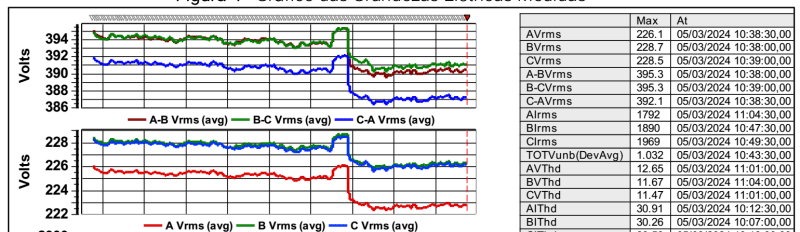

I made some measurement in 3 phase 60Hz 380V, in the input with 3 VFD 500CV same bus.
Below waveforms voltage e current at max load, and resonance probability? maybe between capacitor DC Voltage bus x grid AC cables?
The is 250 metes low voltage cables, betwenn suplly transformes and input AC VFDs.
current_oscillations_around_zero
voltage_commutation_diodes
GS
Fase A have oscillatory transients, and, Phases b c high frequency transients. The waveforms have 512 samples for circle around 30 khz.

Hello Guilhermebr
This could be Middlebrook instability.
Do you have a harmonic filter in series with the input to the VFD?
Do you have a Hi Z impedance on the input to the VFD?
I usually find Middlebrook in a rural installation with a single VFD on a dedicated transformer and many KM of dedicated 11KV or 22KV line supplying the transformer.
If you were to look at the input impedance presented by a VFD, you will find that at operating voltage, the VFD presents a negative impedance in that the slope of voltage against current is negative, not positive.
If the supply impedance is high and inductive, and there is significant capacitance across the input to the VFD (i.e. harmonic filter capacitors), then you effectively have a low frequency tuned circuit with a negative resistance device in parallel. This is an Oscilator. You will probably find that as you reduce the speed, the oscillation will reduce and stop.
In my world, we find that Middlebrook only kicks in around 45Hz.
Reduce the capacitance on the input, reduce the speed, reduce/eliminate the DC Bus compensation in the VFD will all help.

It's input filter + cable oscillation, at about 2kHz.
Power supply seem to be week and cable oversized (very low resistance).
May try to add some resistor across filter output (VFD input).
If no input filter, cable only may do the same for such lenght.

No diodes issue.
As Mark said, may be Middlebrook instability - when output impedance of input filter (or just power supply if no filter) is (or become at some frequency value/range) greater than input impedance of rectifier/converter.
Such oscillations after diode commutation are "normal" for a non-damped line.
Red curve has lower frequency - seems that non-simmetic/equal elements exist on each phase.
The voltage is not equal in the 3 phases, see below.
The impedance not equal, I think that are the power cables from transformer to VFDs
