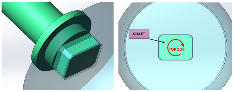

Hello,
I have a shaft under torque,
this shaft is coupled by a rectangular connection to transmit the rotation.
Witch is the maximum bearing stress on the surface in contact in the coupling?
we have:
a= long side
b= short side
L= lenght of connection
I'm drawing a sample for better understanding
Thank you
Fwiw I don't think I can help but that never stopped me from providing thoughts before!
I don't see a drawing yet. How does this clamp to or attach to the cylindrical shaft? Or if there is a transition that will need explanation.
Is there a flexible element in the coupling? What speed will it operate at? It strikes me that square cross-section coupling has a resistance to bending in a given stationary direction which will vary as the coupling rotates.... resulting in oscillating reaction loads and vibration.
Are you (the OP) describing a rectangular-section key?
Here, a picture of square connection:
There is a big stress concentration at the very small radius where the square section joins the circular section. This is most likely your failure point.
On six-sided drives ( like a wrench on a hex head cap screw) at times the contact at the corners has received a great deal of attention. Your square drive may have similar loading.
In addition to the transition mentioned by dvd.
example "Flank drive" as probably originated by Snap-On.
As always, if the load is low or the service life is short, you can get away with practically anything.
