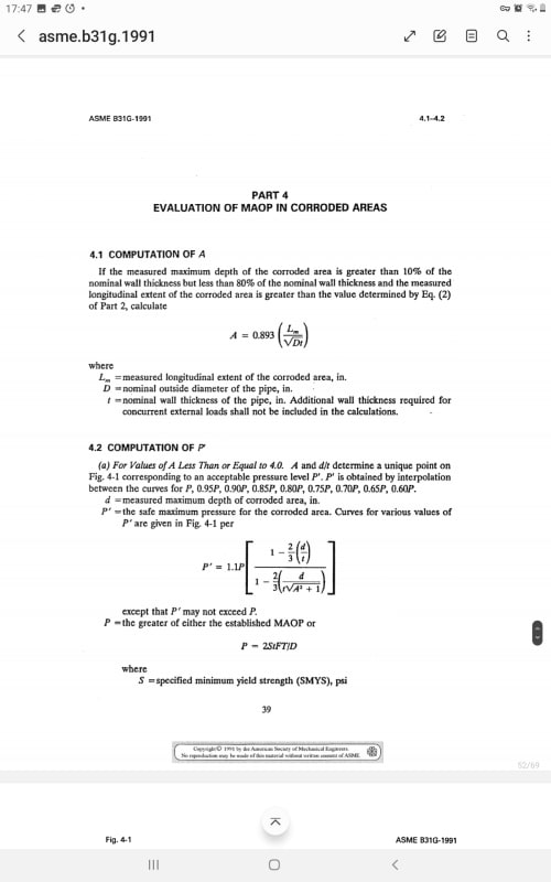

When calculating the remaining wall strength, yes of course you must use the remaining wall thickness. However the formula does not use that value. They use the fraction corroded. Kind of similar, but different. So actually the pressure formula 4.2 itself does use nominal wall thickness, t, to set up that fraction. The remaining uncorroded wall thickness is expressed as (1-d/t), being the a fraction of the remaining wall and is in the numerator, so it is that which is directly related to remaining strength.
No DNV experience.

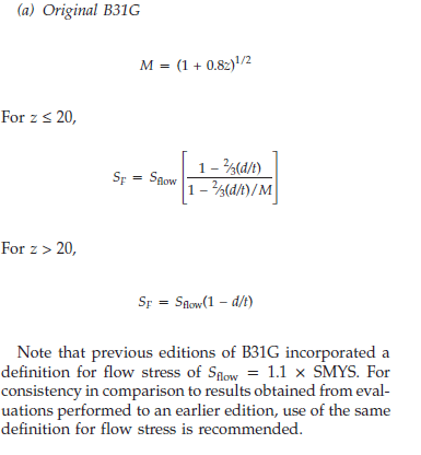

1503-44, my version of the code (2012)shows how to calculate the failure stress, which uses similar equation to yours above. It says to convert it to the failure pressure, Pf, the formula is Pf = 2*Sf*t/D, which uses the nominal thickness. Does this seem right?
There was some talk about the old one being too conservative.
I think this new one is probably less conservative than the old formula.

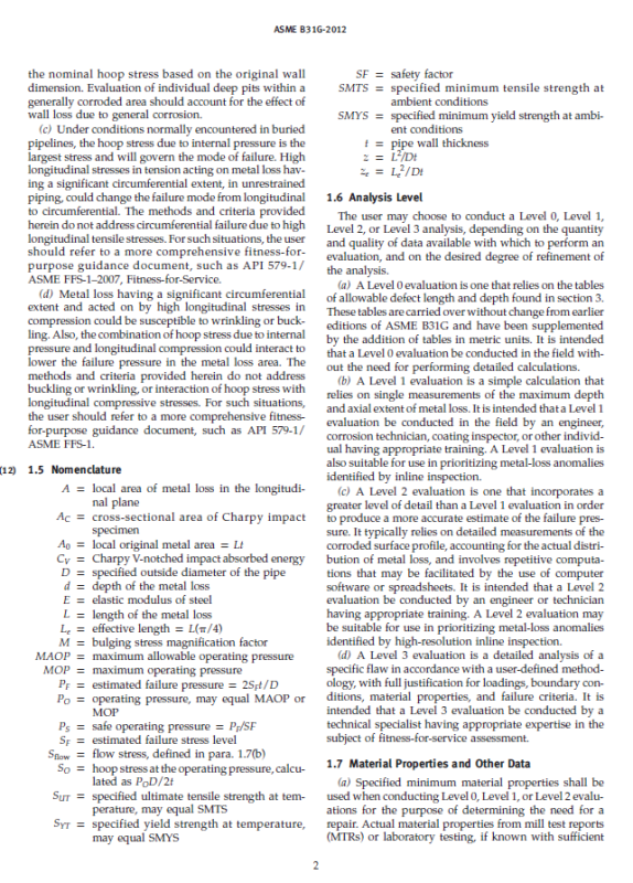

Can you post the page with the variable definitions.
I want to be sure that they didn't change those, because the M term is completely different.
Yes, t = nominal wall thickness
In the criteria for passing
1) P[sub]f[/sub] >= SF x P[sub]o[/sub]
Or
2) S[sub]f[/sub] >= SF x S[sub]o[/sub]
Those two are equivalent evaluation criteria.
#1 is written in terms of pressure, #2 in terms of hoop stress.
Operating Pressure will have a Hoop Stress, S[sub]h[/sub] = P[sub]o[/sub] x D /2 /t
In that equation t is absolutely known to be t, the nominal wall thickness.
So we can also say for certain that at failure
S[sub]f[/sub] = P[sub]o[/sub] x D /2 /t /SF
And t is also the nominal wall thickness there too.
