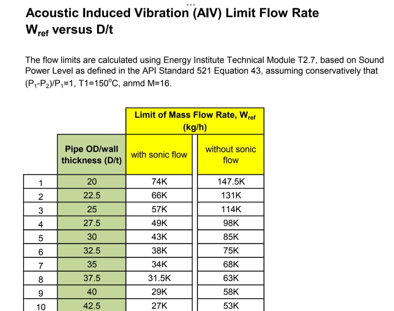

The velocity at which AIV becomes a concern on gas lines is much higher and is dependent on gas density, line velocity, pipe wall thickness and maybe some other parameters also. On gas lines, detailed AIV checks typically need only be done when rho-v2 > 200e3, where rho is in kg/m3, v = m/sec. If you dont have company standards with methods for assessing single phase gas line AIV, then an external engineering contractor who has these methods would be required.
AIV may be occurred at the systems or locations as follows:
- Compressor spill back systems,
- Depressurization systems, blowdown/ plant relief systems
- High pressure gas service piping
The AIV issue of the potential piping can be evaluated per Energy Institute Tech module 2.7 and API-521 per piping noise level 155dB limit. Here is a calculation sample of the pipe D/t vs mass flow rate W for reference

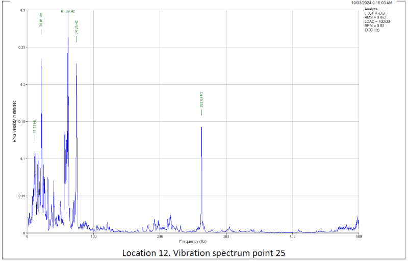

With regards to the vibration reading, it is just a frequency and amplitude reading, not sure if the device (AMS 2140 Machinery Health Analyzer) can tell if it is radial or longitudinal. (attached pic for the readings obtained)

MJ, thanks again for fighting the good fight. This time, the OP did actually say "thank you". But I'll put down my applesauce when I'm damn good and ready. I can only add that the OP has data indicating a fairly high frequency pipe rattle (well, at 250 Hz, maybe more of a moan?), and that can only spell hardship if the flow velocity increases - add energy to a system, and you get to find even more vibration modes to dissipate it. That adage, given to me by an old, grey-haired rocket engine designer some 30 years ago, applies as well to this situation.
