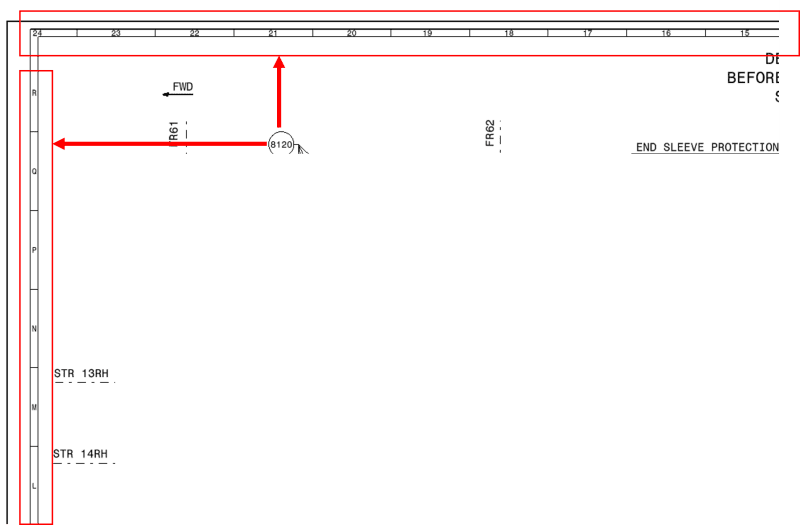

Yes for drawing sheet we have grid or zone values like horizontal numbers and vertical Leterrs like shown below.
Its STD template so wanted to check if the text or balloon belongs to which Zone like "A1,B2,,," like that.
The size of the zones is typically governed by the sheet size; create a look-up table for converting coordinates to zone count and then from zone count to zone ID.
Making things more fun is that some drawing standards have variable sizes for drawings and therefore a variable number of zones. Even so, the number of possible formats is finite and not very large.

Can some help me to get the position of a balloon in catia v5 drawing like H7 as shown in picture.
you will have to get the position of the balloon in the DrawingView, then compute the global sheet position with regards to the position of the view in the sheet.
Then check this balloon global Sheet position with divisions.
if you know the division textname, you can work with position and distances.
Other solution is to work with the sheet layout / format and work from predefined position values.

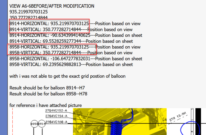

xpos = oDrwView.Item(i).x----Position based on view
ypos = oDrwView.Item(i).y----Position based on view
H = CurrentText.x---Position based on sheet
V = CurrentText.y---Position based on sheet
VIEW A6-6BEFORE/AFTER MODIFICATION
935.219970703125
350.777282714844
8914-HORIZONTAL: 935.219970703125----Position based on view
8914-VIRTICAL: 350.777282714844----Position based on view
8914-HORIZONTAL: -90.6343994140625---Position based on sheet
8914-VIRTICAL: 69.5528259277344---Position based on sheet
8958-HORIZONTAL: 935.219970703125----Position based on view
8958-VIRTICAL: 350.777282714844----Position based on view
8958-HORIZONTAL: -106.647277832031---Position based on sheet
8958-VIRTICAL: 69.2395629882813---Position based on sheet

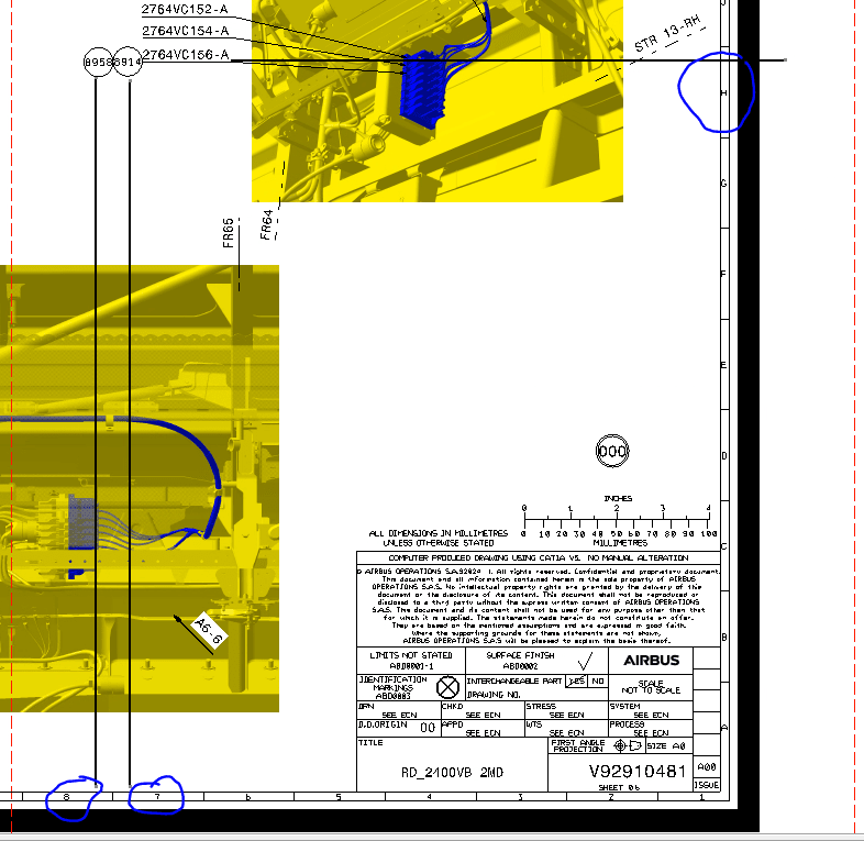

with i was not able to get the exact grid postion of balloon
Result should be for balloon 8914--H7
Result should be for balloon 8958--H78
for reference i have attached picture
the position is the same : it is the view position in the sheet. nothing to do with the balloon.
I might be wrong but i need some real convincing...
Eric N.
the position you get from .X or .Y will not come back with H7 or H8. NEVER
it will come as a value in mm from the origin / reference element
you will have to compare the position (mm) of the balloon with the position (mm) of the H text and 7 text also in mm or compare with the position of the balloon in the sheet and the number of division based on the size of the sheet...
Eric N.
