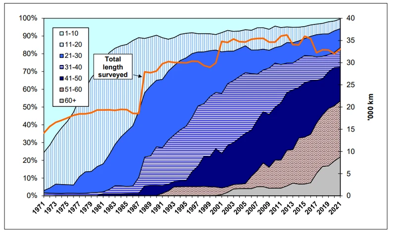

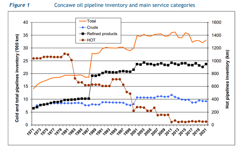

Currently, I am working on a project that necessitates a quantitative risk assessment of crude oil pipelines.
I have collected data on crude oil incidents from the CONCAWE cross country European oil pipeline. The database includes incidents for 3 types of service: crude, refined products, and heated black products (hot oil) over 1971-2021. However, I have used the data from 2001-2002 because as this period includes pipelines that were not previously accounted for in their active pipeline network inventory, making it more representative.
The incidents in the database provide information such as pipe diameter, age of pipe, gross volume and net volume, the facility type (undeground, above ground, and pump station), method of detection, the cause of the spill (mechanical, operational, corrosion, third-party activity, or theft), and contamination in the land (m2) and water (yes/no).
Using the pipeline length and assuming that the age distribution for crude oil pipelines follows the same profile as the total pipeline network (crude, refined products, Hot oil), I calculated the weighted mean age for each year and the pipeline exposure, which is the product of pipeline length and exposed duration. I realized that the crude oil pipeline length remained nearly constant (10,000 km) during the considered period, while the pipeline itself progressively aged over time.
Considering the progressive aging of the pipeline, it is possible that aging could be the contributing factor to the absence of a clear trend in the number of incidents and the failure frequency (calculated as the number of incidents divided by the pipeline exposure) with time?. To remove the impact of random fluctuations, I had to employ a moving average technique.

There are relatively so few failures that is impossible to get any trends.
You would only expect corrosion to be impacted by age of the pipeline.
Usually you find 3rd party interference is your key risk of significant failure as opposed to pinhole leaks

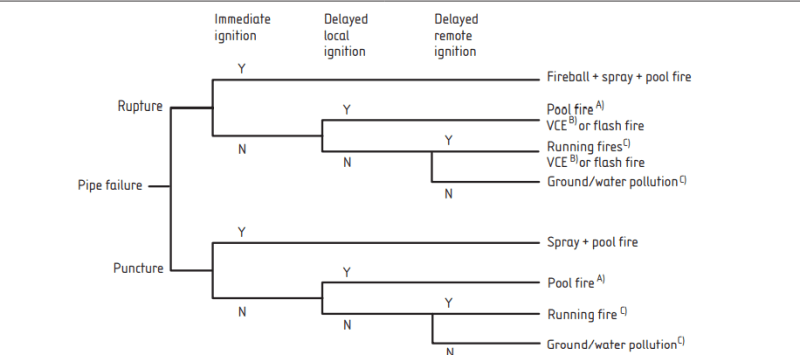

Thank you for providing this resource. Unfortunately, my professor is requiring us to provide something novel within a short time frame. I have read some parts of the standard, and I am wondering what the event tree would look like for the crude oil in the case study I am dealing with.
Given that the the pipeline diameter and wall thickness are 0.3556 and 0.0071 m, respectively. The pipeline is laid underground and the cover depth ranges from 1.7 to 1.9 m. The operating flow rate under normal conditions is 564.4 m3/h. The crude oil is transported at 3.7 MPa and a temperature of 30 °C.transported liquid is crude oil with a density of 880 kg/m3 (29.3 API) and a dynamic viscosity of 0.02 Pa s. The crude oil, as well as the generated vapors, are flammable. The lower and upper flammability limits are 0.9 and 7.0 (% v/v), respectively. The flashpoint is -6 °C, and the autoignition temperature ranges from 10 to 20 °C. The relative density of the vapor ranges between 3 and 5 times the density of air. Additionally, it is mentioned that the True Boiling Point (TBP) curves of this crude oil indicate that 5% of the crude is evaporated at 73 °C.
The failure can occur as a rupture or leak, and I am uncertain about the state of the fluid as it is discharged from the buried pipeline leak or rupture. Will it have enough momentum to displace the depth of cover, which is 1.7-1.9m, causing the portion of the pipe where the rupture or leak is located to be uncovered and release the fluid outdoors? or will the fluid accumulate inside the trench of the pipe?
