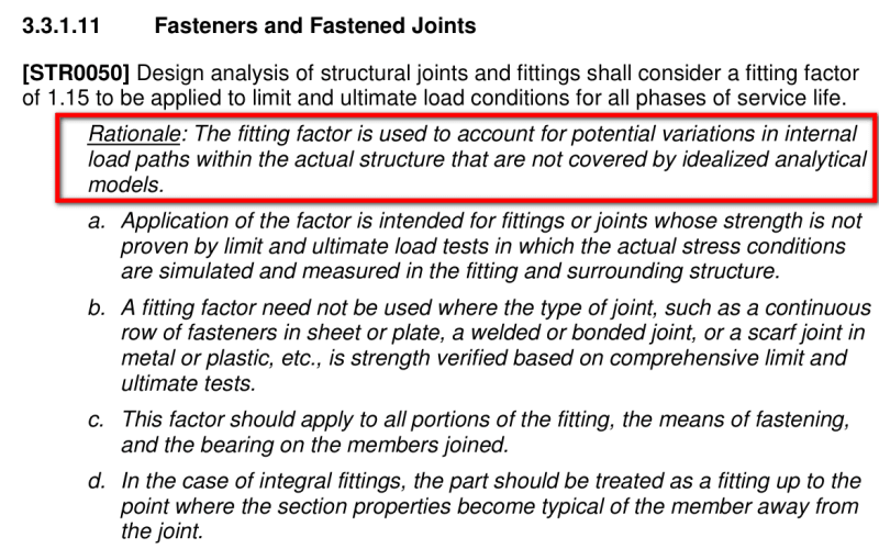

Careful-
A fitting factor reflects uncertainty in the internal stress state (i.e. complex/uncertain internal loads) and may be removed if proof of strength for the detail is shown by test.
You can find its origins in ANC-1, with some more flowery wording, from memory.
Such uncertainty may arise if you have a complex internal load state, usually at points of load introduction eg in a lug. Sufficiently far enough away from points of load introduction, this uncertainty diminishes ( St Venants principle ).
Fitting Factor does not act as a stop-gap for out of tolerance parts, poor manufacturing quality.
In this aspect, the FAA deemed it is too conservative to apply both a conservative 'load uncertainty factor' and a conservative 'material /process variability factor' simultaneously. (Presumably they deem the likelihood of these worst case scenarios coinciding to be extremely improbable, or something along those lines)

I will add this description of the fitting factor from JSC 65828. Contrary to the description given by the FAA (14 CFR § 27.625 - Fitting factors), it contains a very good rationale for the fitting factors (and it is more modern than the description by Peery, D.J., Aircraft Structures, McGraw-Hill, 1959):
Vladimir Gantovnik, PhD
yes, the FF is for concentrated loadpaths (ie, fittings) where ther can be small changes in loads due to small changes in the distribution of a limited number of loadpaths.
