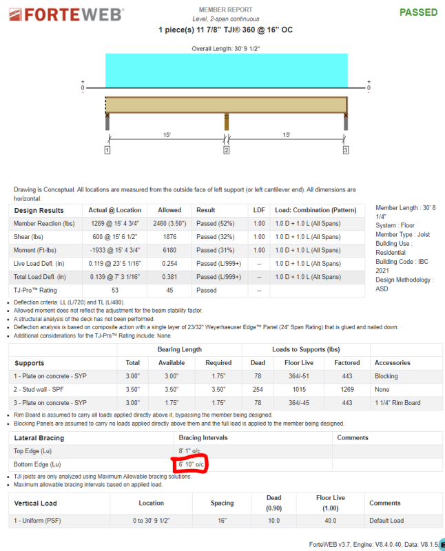

HOWEVER... The ForteWeb Software "Report" says, Bottom Edge Lateral Bracing Intervals of 4'-8" over a 16'-0" span!

I've normally seen the program not require any bottom bracing. Even now I just opened up to see what joist I last modeled and it's required bracing spacing is the full length of the joist - in other words, not bracing. Wondering if you have the settings correct on the "Spans and Supports" tab to set the lateral bracing to full length, or if you have any special circumstances like additional loads, a cantilever?
I'm with YG, my guess is you have the lateral bracing table messed up or have a cantilever.
Or is there uplift on your joists from anywhere?
Maybe if it is 2-span continuous then the bottom flange goes into compression (similar to a cantilever)
Any updates on this lateral bracing issue?
I think that XR250 is correct. For continuous spans, ForteWeb calls for additional bottom edge bracing. I assume because, under unbalanced loading conditions (e.g., one span heavily loaded, and the adjacent span lightly loaded), the bottom flange of the lightly loaded span can go into compression, and therefore could need additional bracing to prevent lateral-torsional buckling.
There is also bottom edge compression at intermediate supports in continuous spans even under uniform loading. Boise Cascade says that "In joist applications, the required connection of the bottom flange to the bearing support is typically considered adequate bracing in these areas." (tech note PDF at link: Link)
As mentioned, this can also happen in cantilevers (bottom edge compression that requires additional bracing), as Weyerhaeuser discusses here: That article points out that simple spans have the compression edge at the top, so the floor sheathing provides the necessary lateral bracing.

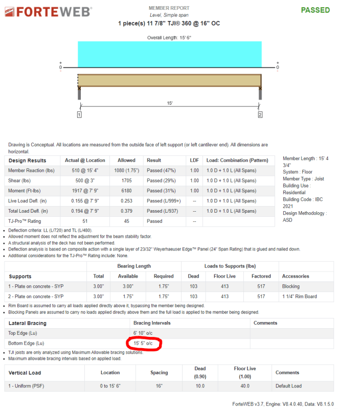

Below are some ForteWeb results for simple and continuous spans. See the "Lateral Bracing" for the bottom edge, circled in red. For two continuous spans of 15', the bottom required edge lateral bracing is 6'10" o.c.
It's strange that Weyerhaeuser would say that bridging is unnecessary unless "an unusual condition exists". Continuous spans seems like a common condition that, apparently, requires additional bottom edge bracing? Unless they are using the terms "bridging" and "bracing" to mean different things in this context?

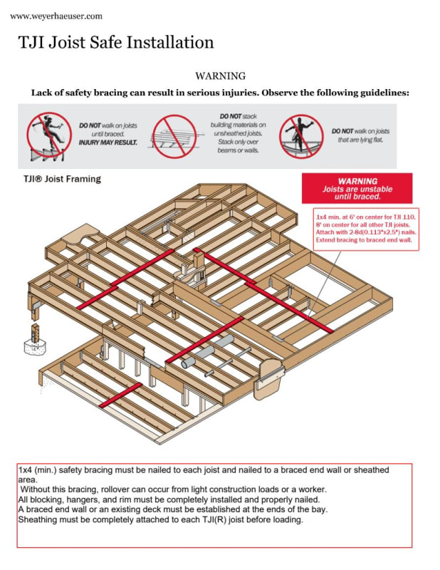

Research of Weyerhaeuser site yielded the answer:
Apparently "bracing" is temporary, required during construction (prior to sheathing).
