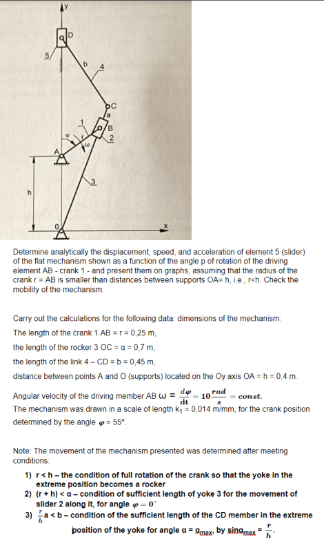

Can someone explain to me the mathematical dependencies of this kinematic mechanism? 1
kajukaa
Student
Mar 22, 2024
5
PL
this is a restart to an old thread.
we've explained the mechanism, as well as we can. AB rotates about A, B moves in a circle. B slides along 0C, C moves in an arc about 0. D moves vertically.
Now I don't think we'll solve the problem for you; I don't think that is a good way for you to learn.
But show us your work and we'll probably help out.
For starters, solve the motion of B, as a function of time (hint ... in both rotational co-ords about A and cartesian co-ords about 0).
This will let you determine 0B (as a function of time) and this should let you determine 0C (the movement of C) ... both these can be done in rotational co-ords about 0 and in cartesian co-ords about 0.
Then you should be able to determine the motion of D.
