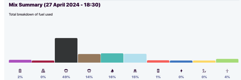

Another take on that is the fuel breakdown over the last 12 months
68% fossil fuel.

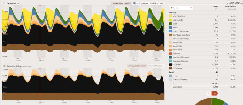

We've got a big high stuck over Australia. As such the wind (the green bit) has stopped blowing continent wide for several days. As you can see several billion dollars worth of battery (pale blue just under hydro) are doing damn all as well. So, if you want to replace coal with wind, you're going to need a lot more wind, and/or hundreds of billion dollars of batteries.

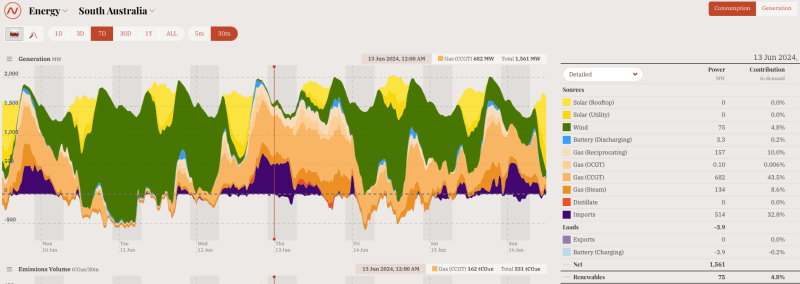

Here's screenshot from openNEM showing the recent performance of South Australia's much vaunted wind powered grid. Note that on the cursored night for 15 hours the grid was 95% powered by gas and imported coal power.
So, if they were going to keep the power on overnight they need 15 hours times 1.5 GW, 22.5 GW of batteries. This will cost around $45 Billion. That's about 1/3 of annual state government expenditure and would have to be repeated every 15-20 years. It's also about 1% of the entire global annual battery manufacturing capacity, to provide one night's power for 2 million people. Battery production is expected to double by 2030, but then other first world countries claim to be going down the wind+solar+storage path, so they will need to buy batteries as well.

22.5 GWh, not GW. Also notice that renewables weren't crash hot for the preceding and follwing days, so that battery size if of the lower end of what is needed.
