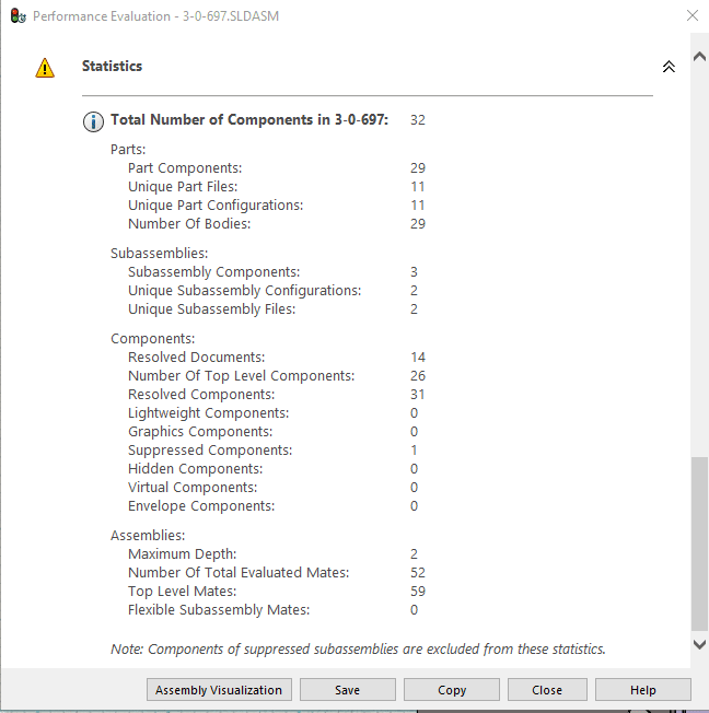

How to count the (total) number of the components in a SolidWorks assembly, including those under subassembly?

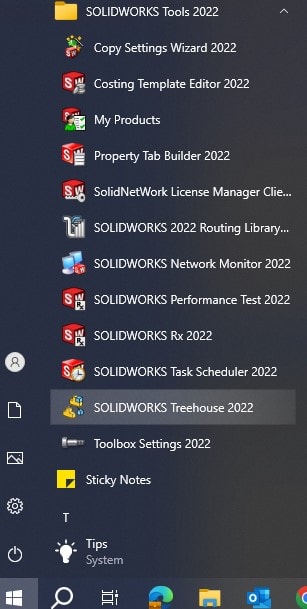

You can open assy in SW Treehouse, then open in Excel.
Chris, CSWP

CAD2015,
I would use the "Performance Evaluation" command on the "Evaluate" toolbar & let Solidworks give you the information.
This is at the bottom of the the dialog box that opens.​
JHD

DraftingMan:
Thanks a lot for your reply, that's the info I needed!

I am a beginner in SW (just three months) and I do not know anything about the SW Treehouse.

ctopher,
Besides what counting the assy components, what other beneficial stuff can we get from the SW Treehouse?..
Thanks,
CAD 2015
It can export the data to Excel. Some users like to do this for some reasons.
