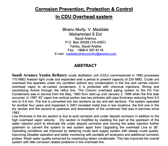

This paper from a 2008 AIChE conference is available by Googling.
