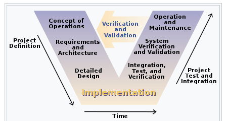

Doesn't that sort of answer your question already? Nevertheless, a rather trivial Google search suggests that "basic engineering" is actually the preliminary design phase, wherein simpler analyses are performed to determine whether a "detailed" or "critical design" phase can be carried forth. In a typical preliminary design phase, size, weight, power, and cost (SWaPC) are essentially rule of thumb estimates, while in the critical design phase, more detailed estimates are based on parts counts, actual drawing dimensions and weights, etc.
Another example would be commissioning plans, where preliminary design calls out only the plan itself, while critical design would have a detailed procedure that would be the actual commissioning documentation and report.
The output of preliminary design is decision to proceed to critical design, based on preliminary SWaPC estimates and confirmation that there are no show stoppers for the program. Critical design output is build/manufacturing drawings, along with test and operational procedures.
TTFN (ta ta for now)
So if you look at the product development V, detail design is the bottom of the V, Basic is the cascade down the left hand side, from customer requirements down to subsystems targets. If you aren't using the V approach, God help you, 1960 is calling, they want their product development methods back..
Cheers
Greg Locock
it looks like PDR and CDR ?
I think so, PDR would be towards the bottom of the left leg, and CDR somewhere very low down on the right leg
Cheers
Greg Locock
I'd have CDR at the base of the V, after detailed design, and PDR 1/2 way down the LH arm
