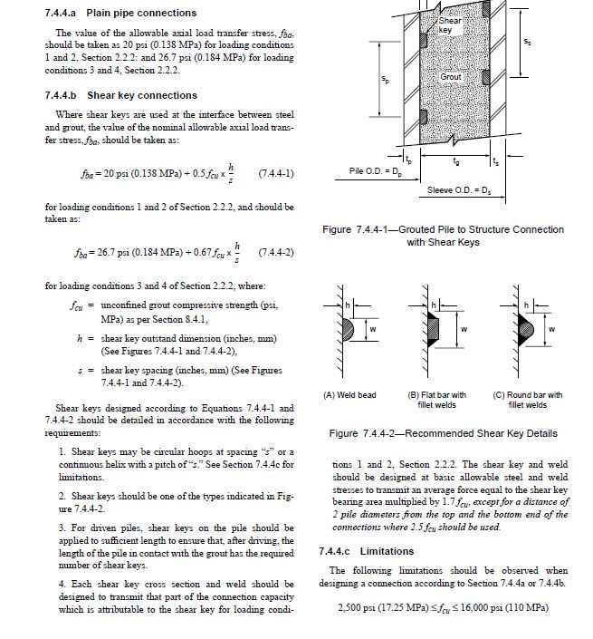

For this item, could you help to explain a bit more. Does reinforced concrete have to be filled to the pile cap? i haven't touch pile design for a while and the pile installation experience is limited. Curious if the socket reinforcement can stop around the bottom of pipe pile and what's the detail will look like to transfer uplift force between socket and pipe pile if this is possible? the reason why i have this idea is because the geotechnical report says " The structural designer should also check the required pile reinforcement that would likely be required to transfer the pile cap forces along the pile and rock-socketed section" but i can't imagine how the load transfer if the reinforcement stop in the middle of pipe pile

- You did not provide a lot of info. here. If the pile length short enough , if you need more compression resistance filling reinforced concrete to the pile cap is an viable option. If you need uplift resistance , and you have substantial pile length ( say more than 20.0 m) the socket reinforcement can stop around the bottom of pipe pile and the detail would be providing welded shear keys at interior of the pile .
- In order to get more info , I will suggest you to look ,
- NCHRP, Rock-Socketed Shafts for Highway Structure Foundations,
- Rock Anchors By Little JOHN
You may look API RECOMMENDED PRACTICE 2A to get the concept of welded shear keys at interior of the pile,
