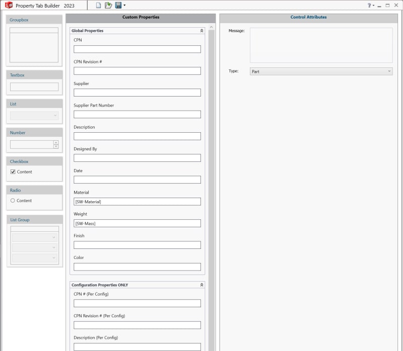

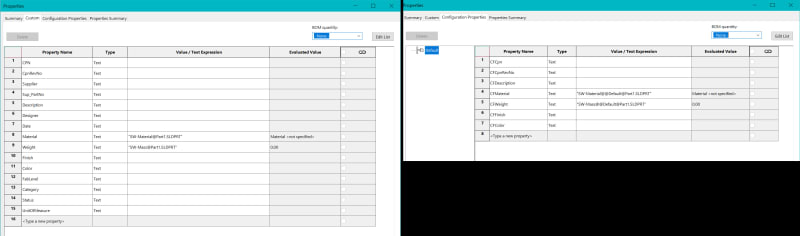

I use the "Property Tab Builder" to make pre-defined properties that I can load into every part, assy and Drawing.

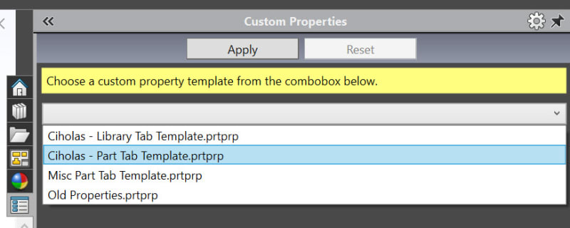

When i start a new part I can select the template:

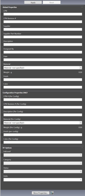

It feeds in all the categories I created and now I can enter them in, or if they are preprogrammed to certain aspects of the file (this works well if you have PDM as the Data Card Data can be automatically added) then it will pull that information over automatically. A simple example would be like Weight or Material.
Then when you select "apply" it adds all the properties into the file.
It is a bit of upfront work, but its so much easier in the long run.

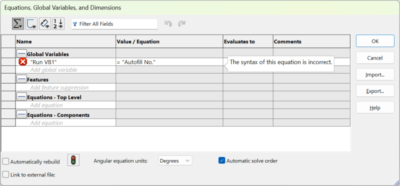

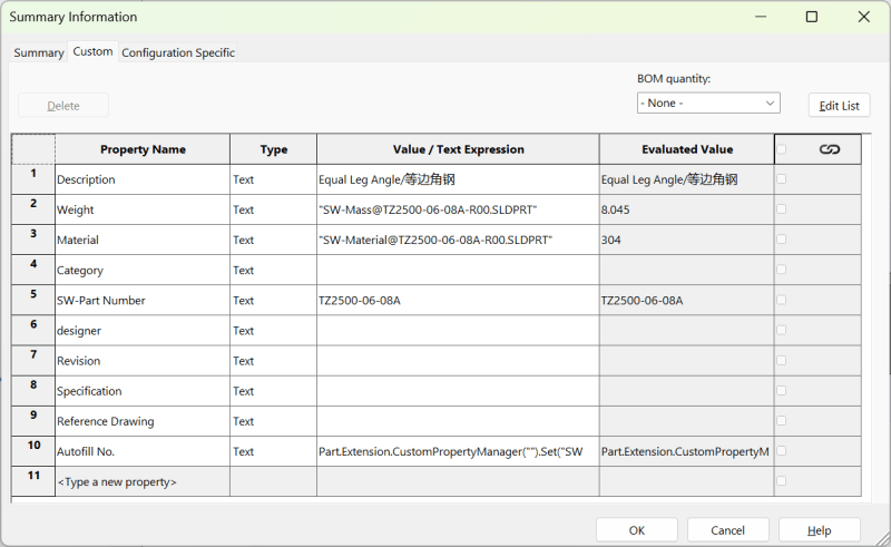

But I find another problem. To autofill part number in drawing file, I create "Autofill No." in custom property, the value is
"Part.Extension.CustomPropertyManager("").Set("SW-Part Number",Rtrim(Left(Part.GetTitle,InStr(Part.GetTitle,"R")-2)))"
My file is "TZ2500-06-08A-R00.sldprt", which part number is "TZ2500-06-08A"
Then in equation like below
it works well for part(sldprt), after rebuild the "SW-Part Number" will be filled with "TZ2500-06-08A" automatically.
but for assembly(sldasm), problem problem problem
I guess there's something different between part and assembly in globle variables.
