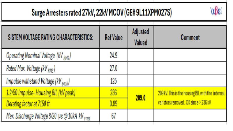

1) First you have to agree with the correct MCOV depending on the grounding method with the contractor.
The parameter is the MCOV.
2) The arresters have non-linear resisters which starts to conduct at a specified overvoltage and therefore no BIL is
defined. Hence it is my understanding that surge arresters are not required to be de-rated according to the elevation.
The surge arrester insulation withstand is easily misunderstood. For seal arresters, the altitude has negligible impact on the internal BIL, However, the altitude impacts the external surge arrester housing
Arrester housing withstand values are not BIL; they are the voltage withstand of the housing when the internal components of the arrester are removed. The voltage across the housing can never exceed the protective levels. Thus, the external insulation is self-protected if its withstand strength is higher than the protective levels corrected for installation altitude. See the table below for additional
details.
