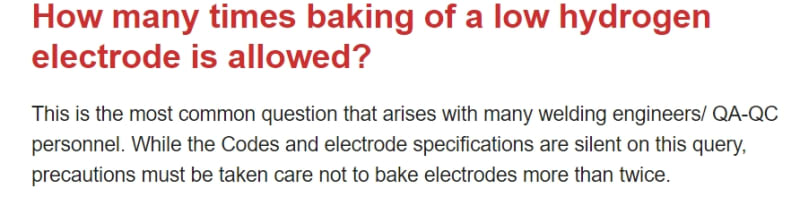

It's my understanding that they can be reheated twice, but I don't know the source.
Just looked it up... one source
Per AWS D1.1 a low hydrogen electrode can be rebaked once at elevated temperature (around 500 degrees F if the time out of the heated electrode oven has been exceeded. If the low hydrogen electrode has been out of the heated electrode oven for less than the permitted exposure time, it can be reconditioned repeatedly.
If the "quiver" is heated to 250 degrees F, the electrodes can be stored without regard to the exposure limits.
Best regards - Al
