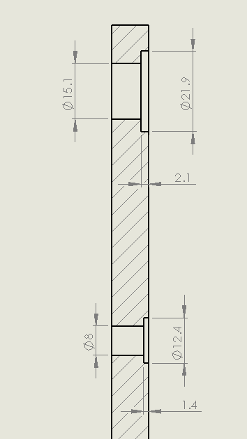

HYDRALIC VALVES PORT SIZE AND SEAL SIZE
SAEEDGH
May 11, 2024
21
HI.
I WAND TO FIND REXROTH HYDRAULIC VALVE PORT SIZE TO CHOOSE SEAL SIZE; ONE OF VALVE IS PRESSURE REDUCING VALVE (DR10/DP2-43/75YM). IT HAS LEACKAGE BETWEEN SUBPLATE AND VALVE. I WOULD'NT LIEK TO OPEN VALVE AND MEASURE SEAL SEAT AND I WAND TO BUY SEAL EARLIER TO DISMOUNTING VALVE.
The DR10 valve has the CETOP 3 (NG6) interface and seals for the interface are available everywhere, just search CETOP 3 interface O rings.
thanks a lot for reply.
but i want size of each Oring. i live in Iran and we can access to seal kits hardly.
thanks a lot for reply.
but i want size of each Oring. i live in Iran and we can access to seal kits hardly.
i dismount this valve. port sizes according to picture. why are there different between cetop 3?
