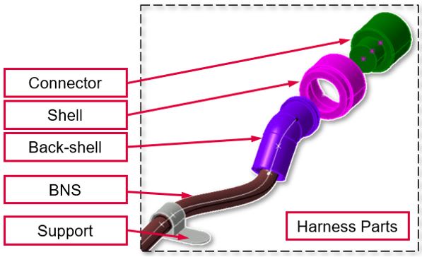

Hi all,
I have a question that has bugged me my whole career of over 20 years as a Harness design Engineer in Automotive and Racing.
I have never used the command in Catia V5 or 3DEXPERIENCE Electrical Part Design called "define shell" and "define shell connection point"
I worked in mass production automotive design and Formula One for many years and never encountered a part that needed to be designed as a shell.
Now I am a Team Leader and some freshers in my team asked me what can be defined as a shell in reality and didn't know what answer to give them.
So I wanted to ask, can anyone give a few examples of what a shell is or can be in reality? What components or group of components can be used as shells?
Cheers!
Image below shows example of a 'Shell' and also a 'Back Shell' component. Hope this helps?
