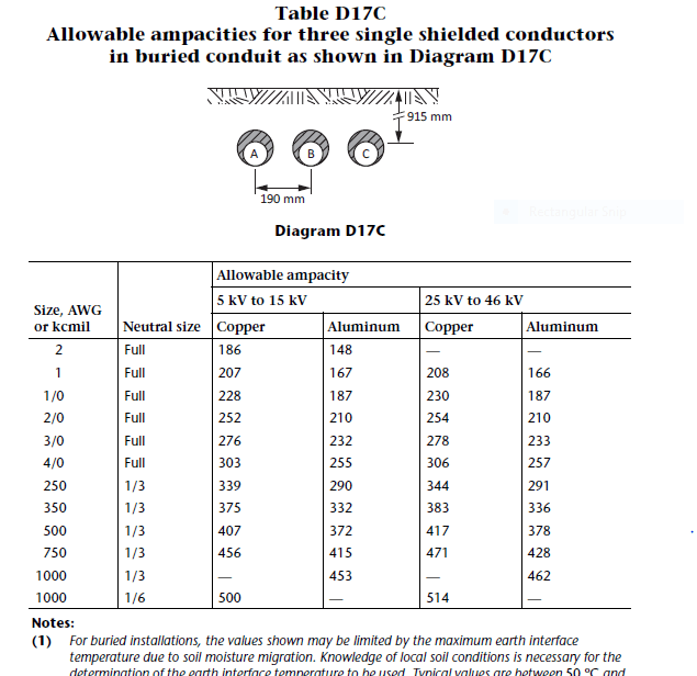

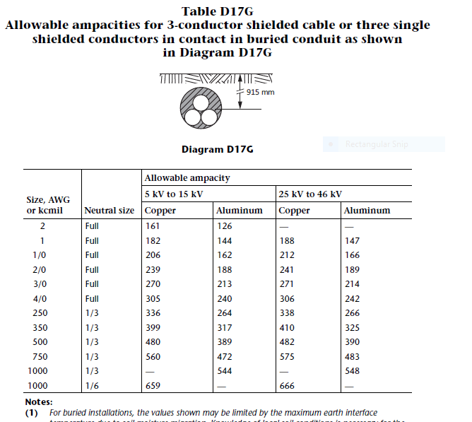

what value does the Canadian Electric Code give for a cable of that type (3 core, XLPE 33kV, 630mm2)?
Single core:
630 mm2 equals 1250 kcmil.
In other tables 1250 kcmil is shown with about 8% higher ampacity than 1000 kcmil.
so, 514 Amps x 1.08 = 555 Amps.
OR
666 Amps x 1.08 = 719 Amps.
