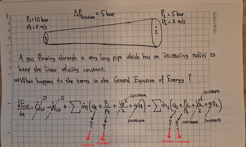

Hello everyone,
I am really struggling when I try to deal with gaseous flows. For liquids, everything is really straightforward for me, the terms in the energy equation, applying Bernoulli's Equation or Energy Equation etc.
But when it comes to gases, I really start to struggle and can't describe the system and what is happening. I can approximate some gaseous systems with Bernoulli, but when it comes to General Equation of Energy, they seem to contradict and Energy Equation seem not intuitively to me.
The equation I am trying to use is this
I always thought that the Bernoulli's Equation and head form of it was coming from the General Equation of Energy. But, the results seem not being interpreted the same.
Below, I have two questions, one is related with an atmospheric tank vent, the other is related with a gas flowing in a very long pipe whose radius is increasing to keep the linear velocity constant. I really do not understand how the terms in the General Equation of Energy changes in these situations.
1)
2)
Thanks in advance.

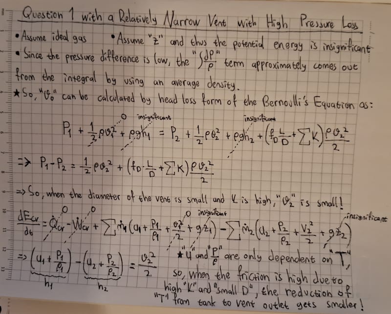

In the first situation the change in stagnation enthalpy inside the tank and the flowing enthalpy in the vent line, assuming no velocity inside tank and gas is at stagnation conditions, equals the increase in velocity as follow:
Hi = Ho + V2/2g
or
Cp(Ti-To) = V2/(2g(778))
where Cp is specific heat in Btu/lb-F
T is deg F
V is velocity in ft/sec
g is gravity constant 32 ft/sec2
778 is conversion from ft-lbs to Btu
So basically the change in enthaply is converted into velocity and also provides energy for frictional flow losses. However any frictional losses does not change the enthalpy since any energy loss to friction is put back into the fluid as heat so temperature or enthalpy does not change with friction, what changes is an increase in entropy and a decrease in stagnation pressure. Therefore the above equation is true with or without friction.
The flow is actually not constant temperature unless there is enough heat transfer into the fluid when it flows into the pipe to offset the energy required, that comes from the decrease in enthalpy, for the increase in kinetic energy needed to increase in velocity. In such case if the temperature wre to remain constant the the Q-in term will not be equal to zerobut would need to equal the kinetic energy term on the right side of the above equation. Although you can consider the flow to be isothermal and apply the isothermal frictional flow equation, true pipe flow is closer to adiabatic where not much heat enters the flowing fluid from the extenal environment. For adiabatic flow with friction more accurate flow equation is the Fanno flow equation. In true fanno flow temperature always decrease because of the reduction in enthaply reqired to provide the energy needed for the increase in velocity.
In the increasing diameter situation the energy from friction loss goes back into the fluid so even though there is energy loss due to friction the enthalpy does not change, what does change is the entropy, ie. loss of usefull work, and stagnation pressure. The stagnation pressure is if you brought the flowing fluid to a stop isentropically so the velocity is re-converted to enthalpy. Upstream the stagnation pressue is higher while after friction downstream the stagnation pressure is lower signifying a loss of available energy and increase in entropy.
You can think of this flow with friction as having two tanks connected to each other with one tank pressurized and a valve is open to equalize pressue in the tanks, it follows the same path on a T-H-S/P-V diagrams. No work was done and no heat was added but the volume occupied increase and pressure decreased changing the pressure and entropy and available energy in exactly the same way on the diagrams as it changes for the flow case you described.

To start, I understand fully the situation on my question 1, thanks to you. In summary, in terms of the General Equation of energy, assuming ideal gas and frictionless environment, mainly the decrease in temperature reduces both "Uo" and "Po/Density0" terms (or as total, the Enthalpy) which accounts for the increase in the velocity. These terms only are dependent on "Temperature" because we already assumed the gas is ideal. I do not have problems until now, I only think that the way to calculate Vo is by Euler's Equation. Even though the situation in General Equation of Energy is fully understood by me, there are two unknowns as the outlet velocity and outlet temperature in it.
And again about Question 1, but with friction this time, I understand that the friction losses of ideal gases in adiabatic systems go back into gases "Internal Energy" or thus "Enthalpy" term. So, no change in "Temperature" and thus no change in "Internal Energy","P/rho", or "Enthalpy". It is intuitive because the energy created due to friction in the form of heat does not have anywere to go due to the adiabatic system, so it goes back to the fluid. However, about the Question 1 - Frictional Case, it can be clearly seen that by using head loss form of Bernoulli's Equation, when there is relatively high amount of friction, the outlet velocity (v2) gets decreased a lot, as you can see from my approximation below:
So, the friction affects the difference between "Internal Energy", "P/rho" and "Enthalpy" terms in the tank and at the outlet of the vent a lot, especially when the friction is relatively high. It decreases the velocity v2, so, there is a smaller need of enthalpy change to account for the velocity creation, right ?
If I am right until now, my question is that is the General Equation of Energy useful in flow calculations of gases ? Because the existence of friction affected all the terms, especially the outlet velocity. Yet, again, this seems not calculatable by the General Equation of Energy. On the other hand, for liquids, the general equation of energy can directly turn to head form of Bernoulli's equation I guess.
About the Question 2, I understand from your explanation that the all the terms are constant in the General Equation of Energy, right ? (The temperature, the p/rho term, internal energy and enthalpy). The reason is that the energy converted to heat due to friction goes back to the fluid since it is an adiabatic system. So, the total energy of the system remains constant.

Lastly, again about Question 2, what would happen when the diameter was not increasing, but constant ? It would be that the temperature would decrease again to account for the increase in velocity which stems from the specific volume expansion from 10 bar to 5 bar, right ?

RESPONSE TO QUESTION 1 (Part 1 of 2)
The amount of friction in a pipe is what limits the flowrate and velocity in a pipe for a given upstream and downstream pressure for flow with friction. There is nothing in the General Energy Equation (GEE) that will predict the flowrate for flow with friction. The GEE can predict the flow for frictionless reversible flow. However, to use the GEE to predict the flow for ideal gas flow without friction you need to know some other conditions such as what type of process it is (isentropic, adiabatic, constant temperature, constant pressure, etc.).
For instance, if you know what type of process it is then you know some other things, for instance if you know it is an isentropic adiabatic process you know that PVk = Constant. So for instance if there were a complete frictionless flow of gas from inside your tank to outside of tank through your vent pipe it would actually follow and adiabatic isentropic expansion process. This assumes the pipe is completely insulated so no heat enters the fluid from the environment as it flows through the pipe to the discharge. Any process where a fluid starts from zero velocity and increases to a final a velocity reversibly without friction is an isentropic expansion process, and the reverse is also true that when a fluid is at a velocity and comes to a complete rest then it follows an isentropic compression path to what called stagnation condition (stagnation pressure, stagnation temperature, stagnation enthalpy, etc.). Then for an isentropic expansion from zero velocity in your tank to a final velocity in your vent pipe without friction then you know P1 (pressure in tank) and P2 (atmospheric pressure at pipe discharge). You also know T1 since that is a given temperature inside the tank. Then you can calculate T2 at the pipe exit since T2 depends on the ratio of P2/P1 and the ratio of specific heats k and there is a formular to find T2 for and isentropic expansion in textbooks. So from the GEE, work W and heat Q are zero and PE is negligible, then the GEE reduces to change in enthalpy:
dH = dKE = V2/2g Where V is velocity in pipe
And by dH = M Cp dT you can now calculate V (using consistent units) where the total dH went into the velocity of the fluid since there was no friction losses. So the General Energy Equation is useful for ideal flow and it also can be used in combination with frictional flow to determine some unknows that would otherwise be unable to be determined.
So for your vent example there is friction in the piping. You have an upstream pressure in the tank and a downstream pressure of atmospheric at the exit of your pipe (assuming the pipe discharges to the atmosphere). The only thing that can make something move in this universe per Newtons laws is a net force on the object. A net force on an object is the only thing that will make it move. Temperature or anything in the energy equation only keeps track of the energy and how it is transferred between U, PV, KE and PE once it starts moving.
So without any flow at time = 0, you have a force of P1*A in the tank acting on the gas in the pipe where A is the crossectional area of the pipe and at the exit of the pipe you have a force of P2*A where P2 is the atmospheric pressure of 0 psig or 14.7 psia. Therefore you have a net force on that fluid in the pipe which causes the fluid to accelerate in accordance with Sum F = M*Acc. Now at T=0 there is a maximum net force on the fluid since you have P1*A acting on one side and P2*A acting on the other side since without velocity there is no friction force. Therefore you have a maximum acceleration of the fluid at T=0. As the fluid accelerates and picks up velocity then the frictional shear forces also increase which act in the same direction of P2*A. So as the velocity increases the net forces on the fluid decrease and so the acceleration decreases until there reaches a point where the velocity reaches a value such that the friction force plus P2*A equals P1*A and there is no more net force and no more acceleration so the fluid is now at steady flow velocity. See attached photo.
And that is how the velocity and flowrate is determined in a pipe. When the velocity reaches a point such that the frictional losses plus P2*A equals the upstream pressure P1*A less the energy required for the KE of the velocity of the fluid. This is the same equation as the Bernoulli equation which you show in your latest post at the top and which can also be derived by the Euler Equation by summing the forces on the fluid streamline.
As I described, friction only determines the maximum flowrate and velocity in a pipe based on the balance of forces and how much energy is available for frictional losses and KE. Friction does not affect any of the terms in the GEE directly but since it limits the velocity then will indirectly affect the terms in the GEE. The higher the pipe friction the lower the resulting flow and velocity and therefore the lower the resulting change in enthalpy. If there is a lower velocity then yes the enthalpy has to decrease less to provide the KE for that velocity change.
The GEE only keeps track of how energy is converted from one form to another and can be used to predict flow for ideal non-frictional flow. It is also useful in determining unknowns through the use of energy relations. To predict flow and velocity for frictional flow one of the frictional flow equations previously mentioned must be used.
Yes correct. This is called Fanno Flow which considers adiabatic flow in a constant area duct with friction. If you do a search you will find alot of info on Fanno Flow calculations. A good book that I learned compressible flow from and Fanno Flow equations is "Compressible Fluid Flow", by Michel A. Saad.
