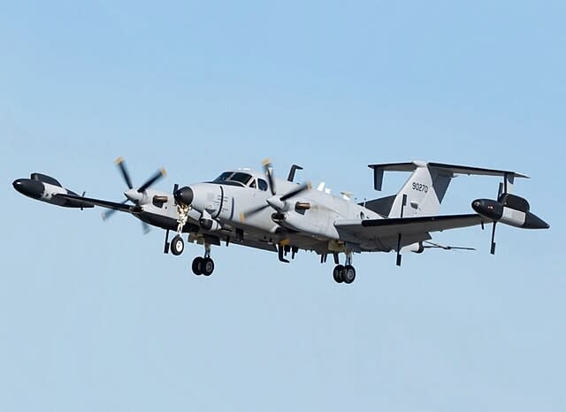

The fuselage crown and belly skins... on centerline... are in an ideal location for antennas [~symmetrical antenna radiation patterns, drag, etc] and 'other penetrations'.
Skins that were 0.050[clad?]... that were chem-milled to 0.032[+/-0.0??] in pockets between frames/stiffeners/stringers/etc... are a acceptable way to save weight. BUT the OEM may have been 'short sighted' looking for every ounce of weight savings.
IF a +10.0-min wide** zone [strip] down the fuselage crown CL [and belly CL, too] had been left full thickness... 0.050 clad[?]... then mounting future penetrating equipment [antennas, etc... in future equipment installs] would be far-less of a difficult issue... and the weight/balance differences could turn-out to be beneficially-negligible.
**zone-width adjusted for any CL mounted stringers... or perhaps a CL stringer NOT installed and an adequate gap for future small antenna/etc installs...
I often see Army RC/UC/EC-12s flying around with a ridiculous number of antennas and internal equipment installs. I'm sure these aircraft are built with considerations for all these installed/future mods [penetrations, masses, aero-loads... all-over] in-mind.
Just thinking-out-loud for future consideration.
