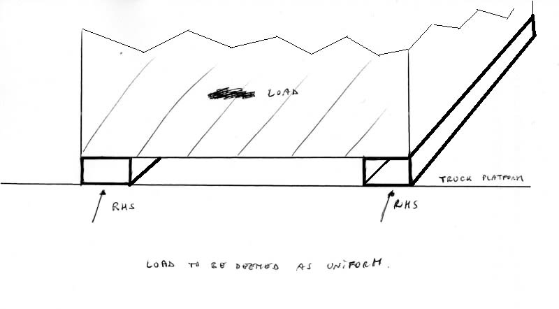

any suggestion or previous threads (calcs, I mean) on RHS used as supports il truck loading ?

The attached sketch is how I interpret your diagram- if I'm missing it, please correct.
JStephen : your interpretation is correct. Thks
Could you estimate the safe load by considering the shear capacity of a box section the same size as the short side of the rectangular box? The failure mode is pretty much the same and I don't think the longer length would make a significant difference...?
