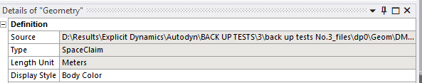

Dear NRP99,
thank you kindly for your reply. I couldn't find the "element control" option nowhere in Explicit Dynamics, though it is available in the Static & Transient Structural. Below is an image of the available options displayed in the details of "geometry" => Definition tab. I will follow your alternative suggestions and see what the outcome of those will be. Thanks again your reply.
Are you using Autodyn? Might be Autodyn only supports reduced integration. Please check the Autodyn help documentation/User Manual/guide.
Sorry. Currently, I have no access to Ansys. May be you can play with the stiffness in the Flanagan Belytschko damping, mesh refinement in critical area and other options provided in documention mentioned above.
