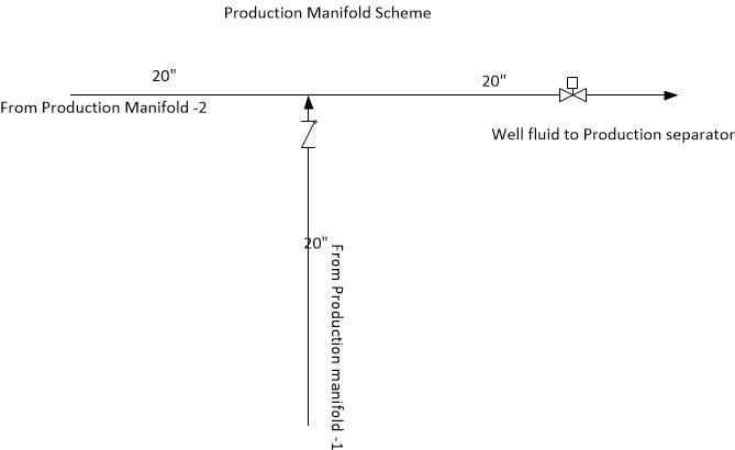

We found baffle plates in production line before joining another production line. Production separator is 100 meter away from the tee joint. a sketch and photo of baffle plates are attached. can anyone please explain the purpose of these baffles plates. theory / concept of these baffles will be very helpful.

If you look attached sketch along with picture then you will note that there is two production manifolds each with 20" dia. one manifold is located about 2 km away from 2nd one. Joining in one point and then routed to production separator which 100 meter away. we don't have record of this installations as these manifolds were constructed in 1960s. During maintenance team they found and they asked the question for these baffle plates. I also don't know and my colleagues as well. this is reason posting this question here.

check valve was dropped for maintenance and they found baffles plates inside.
Now I've had a look on my main monitor and not my phone, that looks very much to me like an amatuerish attempt at a barred tee to allow pigs to travel along the main line from production manifold 2 towards the separator. Maybe they only used it for commissioning or testing? who knows?
Some look like they are hanging loose or have snapped off.

Looking at your P&ID, I see your flow arrows and the orientation of your check valve. Is the orientation shown correctly?

Baffled Tees are common in oil and gas. The internal baffles act as barriers to redirect the flow in a controlled manner.This redirection helps prevent the swirling, eddies, and pressure drops that can occur when fluid encounters sudden changes in direction.
As the fluid flows through the baffle tee, it encounters the obstruction caused by the baffle plate. This obstruction disrupts the laminar flow and creates turbulent eddies and vortices. The turbulent flow increases the contact between the fluid and the wall of the tee, facilitating better mixing and preventing any stagnation or dead zones.
Imagine rocks that comes in the path of a flowing stream.
In oil and gas industry, it is used in separation, mixing and transportation.

GDD, Thanks, I reached to the same conclusion.
