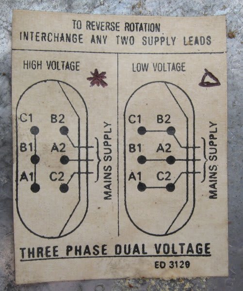

Hello - forgive me as this is not my expertise -- but I have a customer claiming that when they wire up an electric motor (230/460V dual rated motor) --- that when it's wired for 230V, it runs in one direction. And when they hook that same motor up for 460V, it runs the opposite direction.
Let's assume they wired it up the same way with each phase for both --- is this a possible outcome? I have asked a couple of electric engineers who have said it's not but the customer is adamant about it. He is one to never admit he's wrong so I'm trying to have multiple sources to prove it's not possible. I think they are potentially just mixing up phases when changing the voltage connections -- which could cause the opposite rotation.
However, if it is possible, then please let me know. Thanks in advance!
Wait, they have both 230 and 460 V, 3 phase supplies available in the same facility?
The label below is self-explanatory.

Here's the likely problem. Someone wired the facility (or somewhere in the facility) backwards between the two. No one has noticed because whenever they hook up a motor, if it runs backwards, they just swap the leads and tell no one.
Except on this motor.
They are probably following the color code correctly at the motor, but it needs to be traced farther back.
Is it possible the motor maker screwed this up? I guess. But it is far more likely for the electricians wiring a factory to make a mistake than for a motor winder to do so.
The answer is to have an electrician confirm the phase relationship between the two supplies. The trouble may be in getting a tester with the upper voltage range. Maybe this: though the electricals here likely have a better recommendation.

By the way, if they reconnect an existing 460 Volt motor for 230 Volts it will run backwards on the same system.

A dual voltage motor can run in opposite direction only if the phase sequences 230 V and 460 V systems are not the same. And I still doubt a facility could have two low voltage systems.
Reading between the lines;
when it's wired for 230V, it runs in one direction. Assume that they had a 208V or 240V source to check rotation.
when they hook that same motor up for 460V, it runs the opposite direction Assume that they had a 208V or 240V source to check rotation.

WAIT. THEY JUST DID THAT.
The test results?
The phase rotation of the 240 Volt system is opposite to the phase rotation of the 480 Volt system.

A second test that doesn't need a tester and may be more demonstrative.
Connect a 460 Volt motor to 480 Volts and check the direction of rotation.
Without changing any connections, connect the motor to the 240 Volt source and watch it turn backwards.
Reverse the main connections on the 240 Volt system, or at least on the 240 Volt test rack.
