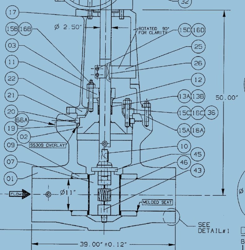

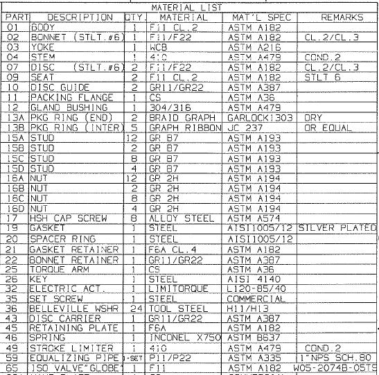

The current valve is a Pressure seal Parallel slide gate valve
see picture below
Seems like Ring-O maybe Safe-O seal valve or copy of it. Easily 30+ years old
Not good:
- Diaphragm (under item 02) and ring seal 20 subject for fatigue due to pressure cycles
- when not fully energized (usually first stage of start-up), this valve have leakage path to outside (see hole next to 21). I wont be stand next to it knowing that Syngas is inside
- when valve fully open, top cavity sooner or later will be filled up with particles. of which will hardened. Browse through conduit gate valve, you'll see the complete difference of cavity 'protected' when it is close, half open and fully open position.
