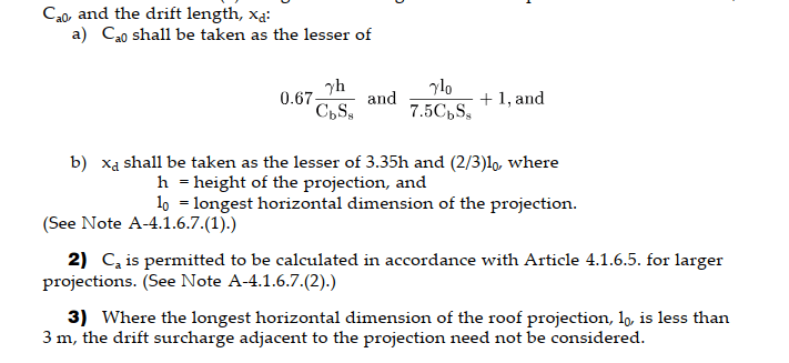

To give some context, when running it as a roof projection, with 31m l0 representing half of the perimeter, I get a 14kPa drift that is 20m long. If i take l0 as 20m (the diameter of my cone shape) its a 10kPa drift thats 16m long. Both of these are assuming the height is 7m since that is the height from top of roof to the peak of this structure, because I can't rationalize an appropriate height to take as alluded to above.
If ran as a high-low condition, the case 2 yields much more reasonable results of 5.8kPa of 6m length, assuming the source area is the area of my cone roof.
Neither of the values above include sliding, which would be added to them. Sliding would have a greater influence on my shorter drifts as the code indicates to distribute the sliding snow over the length xd.

Oh, it's a cone. I was envisioning a ridge line, similar to the classic Pizza Hut roof profile. It sounds like the fetch distance is actually pretty long. With a round cone, I imagine the drifted snow would cover some arc length on the leeward side representing the wind "shade" area. How does the projection height factor into drift with NBCC? I'm just not very familiar with the NBCC.
The driving factor for magnitude is defined as shown below:
Length typically governs past a certain point and acts as a sort of cap to how wild the height can run, however with a projection as long as what I am dealing with, the height is allowed to influence much longer.
I wish there was something to help with snow blowing up to a sloped structure. I've considered treating it as a projection, but then spreading it out over a larger area that creeps up the cone a bit (creep up the slope to whatever height of drift is) and then that would lower my overall kPa at the high end.
Since it's a cone, I could get behind using the average height as your h. Especially if you're going to add in sliding snow on top of whatever drift you come up with.
For what it's worth, if this a local project for you, something like your 5.8-6 kPa plus sliding snow really feels like it's in the right ballpark.
