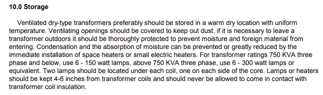

Below is a clip from Virginia Transformer Corp. instructions for their dry-type transformers.
Be sure to never exceed the transformer max winding temp.
