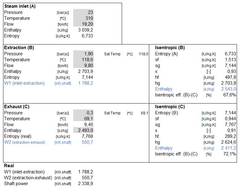

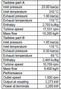

Hi all! Sorry for the late reply. Vacations.
I've searched an alternativa use case for this analysis. Please see below the turbine data and my calculation, also with my questions:
Turbine data:
My calculations:
Questions:
1) My total real power (underlined in red) is below the power indicated by the manufacturer. Any explanation?
2) I've searched in other turbine data and this occurs in everyone: the enthalpy indicated in the condensation outlet conditions is allways bellow than the one indicated in the steam tables and this leads to higher powers, accordingly with the indicated by the manufacturers. But how is defined that outlet enthalpy, that doesn't match the steam tables?
Thanks again!
The manufacturer estimates the final exhaust stream has some moisture in it for the expected isentropic eff at this speed for the LP turbine, so the exhaust enthalpy is expected to be lower than 2625kJ/kg/degK. So total power extracted will be somewhat more. There is no harm in having some moisture at LP turbine exhaust, as long as BFW is on spec re silica content. Up to about 10% moisture content in the exhaust stream appears to be the permissible upper limit for condensing turbines. Vendor exit enthalphy of 2493kJ/kg corresponds to 5.7% wt moisture content in exit stream - okay.

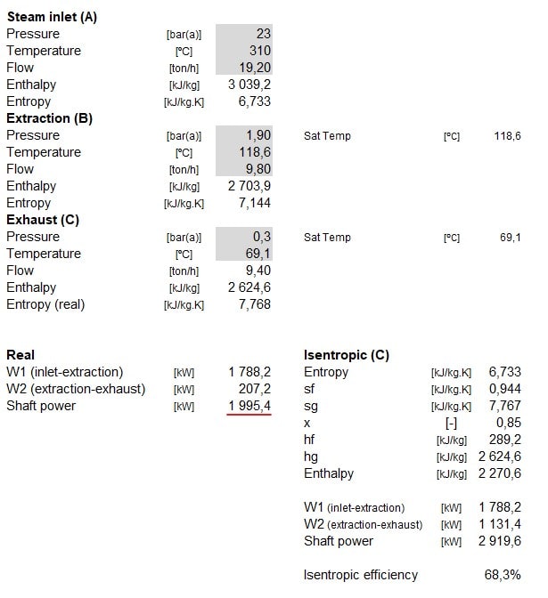

Dear georgeverghese,
Thank you so much for the feedback, again!
I understood perfectly what you've said!
So, in practical ways, to get the exact power we must get the manufacturer enthalpy value at the outlet, correct? If we are making a study (and we don't have yet this value), the only way to estimate this enthalpy (and therefore the power), is to assume an isentropic efficiency and then calculate it. Do you agree?
Onde other question is regarding the power, with the corrected values (below), i found that my shaft power is a bit higher, despite all the enthalpies are equal. Any idea?
For backpressure turbines, should we expect to have steam without moisture or slightly overheated, or is it possible to have moisture content? (Probably is dependable on the use of this steam in the process after).
Thanks!!!
I have calculated Steam Turbine-Generator output and turbine overall (HP/LP) efficiency. Please see the attached PDF of my spreadsheet.
You will note that I have included estimated percentages for mechanical and electrical (generator) losses based on my experience. Although the value of the output at the generator terminals, which I calculated, is close to the manufacturer’s value, it does not match exactly.
It is not possible to match the manufacturer’s value without a detailed heat balance diagram. A detailed heat balance must include all shaft leakages with pressures and enthalpies (for the leakage and mix enthalpies) at the return to the turbine blade path. In addition, the heat balance must include the mechanical and electrical losses.
For backpressure turbines, I would not expect any moisture in the LP turbine exhaust, but that depends on the exhaust pressure and isentropic efficiency of the turbine. As the exhaust pressure rises, it is less likely to be wet.
Best of luck!
 https://files.engineering.com/getfile.aspx?folder=e95cbe92-dbb4-41cc-b46e-8f1798f7aaf8&file=STG_Output-Efficiency_Calc.pdf
That 3% difference between 2339kW and 2273kW total output may be due to some other losses within or outside the turbine (internal bearings, internal speed reduction gear between HP and LP turbine, gearbox from LP turbine to generator shaft). Presume "power at coupling" means shaft power at generator input after gearbox and flex coupling ?
