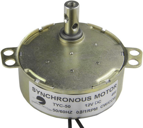

The motor I'm using is a 12V Synchronous DC geared 1 RPM motor. It's just a simple one you can buy on Amazon and I'll post the link to it:

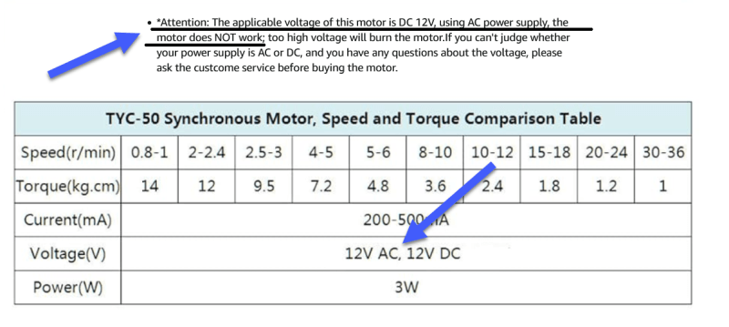

The sellers note:
*Attention: The applicable voltage of this motor is DC 12V, using AC power supply, the motor does NOT work; too high voltage will burn the motor.If you can't judge whether your power supply is AC or DC, and you have any questions about the voltage, please ask the custcome service before buying the motor.
What is "custcome service"?
My guess, they are juicing the search engines to get clicks by adding the frequency and "synchronous" to their listings, which also appear on ebay and Walmart, and many, many others.
I won't include a link to their website but the first image I was presented with was a tiny motor to use as a tablesaw with a blade on one end of the shaft and a drill chuck on the other end. Maybe they make great motors, but their advertising is nuts.

There is no such thing as a "synchronous" motor powered by DC. And how the heck is something simultaneously "12V DC" and "50/60 Hz"? There is no such thing as DC power that has a frequency.
I don't know what the eff is inside that little enclosure, but it isn't what the label says is inside it, and it isn't what the ad says it is.
I would strongly suggest that you have separate power supply to the motor (not fed through the dimmer switch) and to the lights (dumb resistive load). If you insist on using that particular motor, I would suggest that you get one in hand and do some testing on it before you commit to a circuit design. See what happens if you put 12 volts DC to it (jumper cables to a car battery). If it really is a "synchronous" motor, thus expecting AC input, I suspect the motor will stay put and let out heat and smoke. Maybe even fire. Might be spectacular. I have an old electric lawnmower that let out smoke and stink a couple months ago. I should take it apart to see what it looks like (and smells like). Doesn't work no more. (Popped the circuit breaker before setting anything on fire)

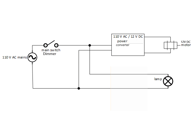

Also, I added a diagram just to show with a bit more clarity what I'm trying to do. Thanks for looking!
Use the image button. If that button isn't working, allow Javacript to run for this forum.
Something like this.

The motor won't be on the dimmer. The motor will be on the power supply. The power supply is on the dimmer.
With the power supply on the dimmer, and with a chopping dimmer, the power supply should output 12 VDC even as the input is dimmed.
It depends on both the waveform of the dimmer and the internal circuitry of the power supply, as to how far the AC voltage may be dimmed before the motor voltage drops.
A higher wattage power supply may hold up the output voltage under the motor load at lower levels of dimming.
My suggestion is to buy one (or two or three) power supplies and a generic dimmer and try some tests.
You may also be well to try several different brands of dimmers. (Different manufacturers, not the same dimmer with a different name slapped on by a reseller)
